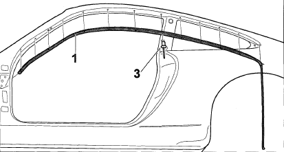

1. Remove the door panel to gain access to the holding clip.
2. Press out clip with a plastic spatula.
3. Pull off door seal on the outside.
4. Carefully pull the seal out of the clips along the door contour.
First position door seal on the outside at the top edge of the door and push it on.
Rest of the installation is the reverse of above.
