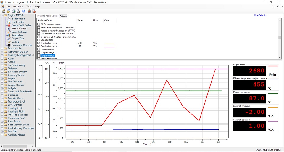

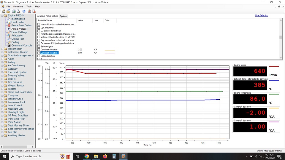

I've read a bunch on the VR6 boards that the HPFP might be out of timing due to a loose chain (stretch or broken guides) and that is what is causing the error. I do not hear any chain rattle. I pulled the camshaft deviation values and they are -2/+1. A VW tech guide says replace if 8 degrees off but there is one video diagnostic showing a misaligned fuel pump, when they dug in the guide was broken.
Looks like I only needed to do the PCV. After pulling the intake and replacing the PCV I have not experienced the code. My timing chain was tight and no evidence of broken guides.
