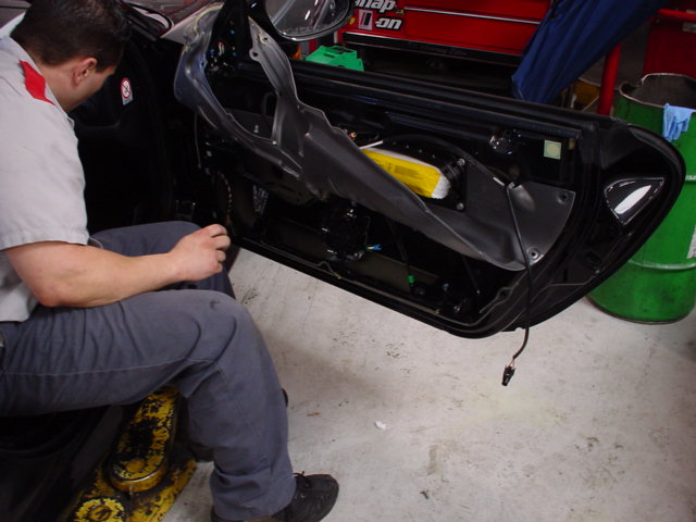

It is sometimes necessary to remove the side airbag to replace the door glass. I personally have been able to remove the window regulator without doing this but sometimes I have too loosen the four M6 bolts just enough to allow the airbag to give me some room. Warranty actually pays the tech to reset the airbag light for the tech would have to check window operation and adjust if necessary which pops the light on. Dealer should reset without any cost from you with the PST2 Tester.
I watched a mechanic I know replace the window regulator, and of course he had to first remove the door panel, glass, and then the regulator. The side air bag was not touched or disconnected, and the battery was not disconnected - but I did not know that untill he turned on the key to run the window up and down for a test before he put the panel back on. I expected an air bag light when he turned the ignition on to test the window function.
