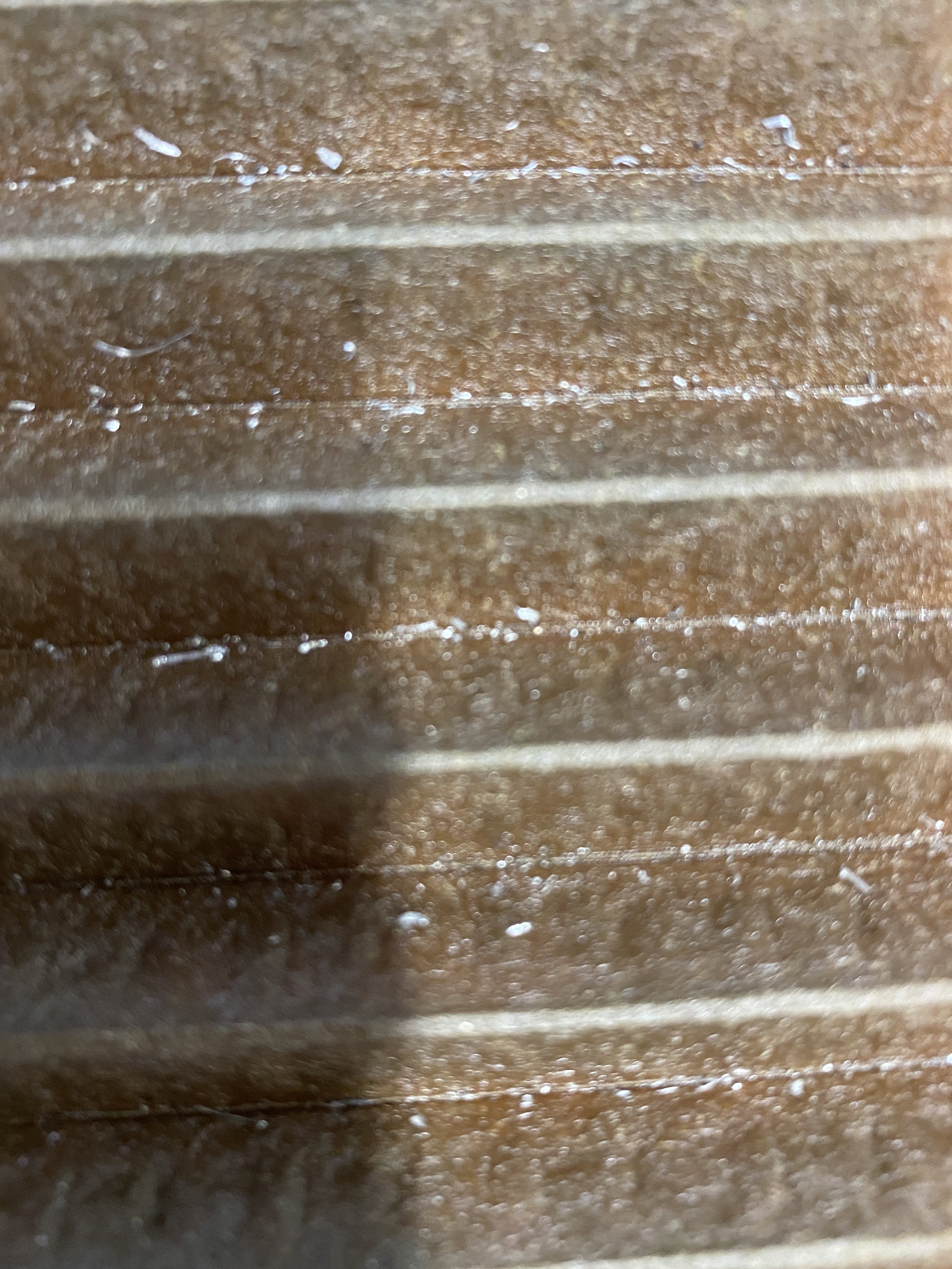

Changed oil and filter and discovered this when inspecting filter element.  2003 Carrera, 54K miles, uses 1 quart every 3000 miles.  Thoughts on possible causes appreciated.image.thumb.jpeg.76a846b1a936cd08f2958fa2bef42d5a.jpegimage.thumb.jpeg.9e00891ec84a7ab16dbbd2535c211d1d.jpeg

IMS.
good luck.
do a deep dive into forum information.
might be too late. Hope you figure out a better answer.
Check one of the specs and see if it can be picked up by a magnet (ferrous), if it does, your IMS is probably on its way out; if the magnet doesn't pick it up, it is an alloy, probably cylinder wall.
Seems to be ferrous.  Most picked up by magnet.  IMSB changed 7 years ago.  Will be dropping oil pan later today and I have sent off for an oil analysis.
An oil analysis is not going to help, ferrous metal is most likely the sign of a major league problem developing.  You need to think about trying to locate the source before something really bad happens.  And even if it is an IMS bearing, you cannot just replace it, the engine will need to come apart, if for no other reason than to clean the metal out of the oil passages.
Then its a rebuild, next to impossible in Hawaii, or a replacement.  I will start looking around for replacements.  Anyone have suggestions as to where.  I could ship the car to my brother-in-law in San Diego for repair.

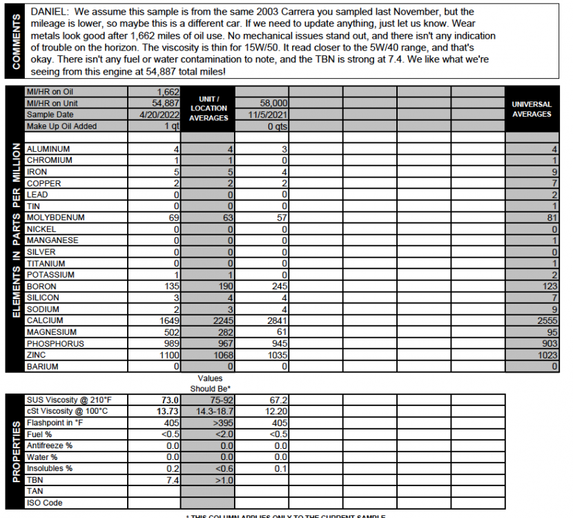

These results were from an oil change when I first got the car.  The oil only had around 1000 miles on it at the time.
You could also get a good engine out of a wreck and install it, which is usually the lowest cost option.
Sorry you are caught up in this.
there was a class action suit against Porsche a few years ago Re IMS issues.  Lots of engines replaced for free as I recall. I missed out because I  installed the LME upgrade to minimalise IMS failure potential.
there were shops around that would do an engine swap at a price of course. It’s a Porsche after all. Good luck.  Look around.

Is that Mobil1 15w-50?  13.73 is thin for a 15W50, I agree, especially after such short mileage.  My 0w40 has that viscosity even after 5K OCIs.  Overall nothing jumps out -- wear metals aren't very high but the OCI is very short.
p.s. I saw on Rennlist, it looks like the tension spring from the RMS.
The 1 quart added over that time wasn't 15W/50.  I remember it as 10W/40.  It was all I had at the time.
I see but how did it need a quart top up in 1,662 miles if you said it only burns a quart every 3,000 miles?  Maybe you only added half a quart?
Either way, mixing in a lower viscosity oil would explain, at least in part, the thinning of the oil... still seems pretty thin overall given that the majority was 15W/50.
FWIW Blackstone's fuel dilution measurement isn't that reliable from what I have seen
