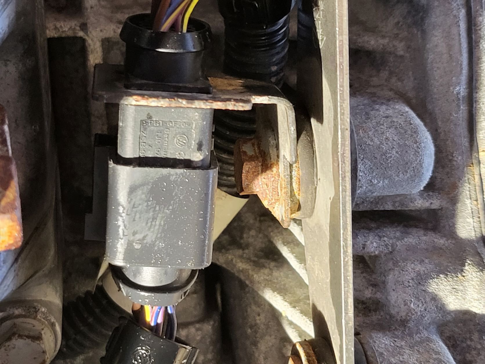

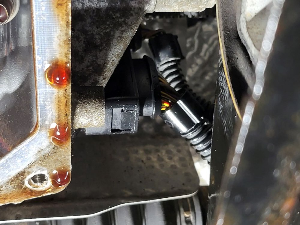

Heading out to pull the pan and inspect the wiring! Hoping to find something obvious.
Unfortunately, a stuck or dead solenoid looks exactly like a brand new one right out of the box; the problem is internal.
JFP you are right, everything looks good. there is nothing loose.  I did find out the reason for 3rd gear is it is the only gear that does not need power hence its the onloy gear that is working.  Any ideas how I would check for power to the harness?

I would be willing to bet you already have power to the harness, otherwise you would be getting an "open circuit" code, which you do not have currently, and the vehicle has gone into "limp mode".  The code you are getting is pretty specific, the solenoid is not moving when it should, which also implies power in the system.  You have a jammed solenoid, which needs replacing.  When one jams, it is a good idea to replace them all, as one usually follows the others.  A full set (aftermarket) retails in the $400 range, plus labor and fluid. Just be aware Porsche does not sell solenoids by themselves, they will tell you that you need a new transmission.  Most aftermarket shops simply replace the entire valve body with solenoids with a rebuilt unit with new solenoids, ($700-800 for the unit) which usually fixes the problems.
Ninety-nine times out of one hundred, problems like this result from Porsche's ridiculous tip oil service intervals; the trans should get fresh fluid and a filter at least every 45-50K miles.
