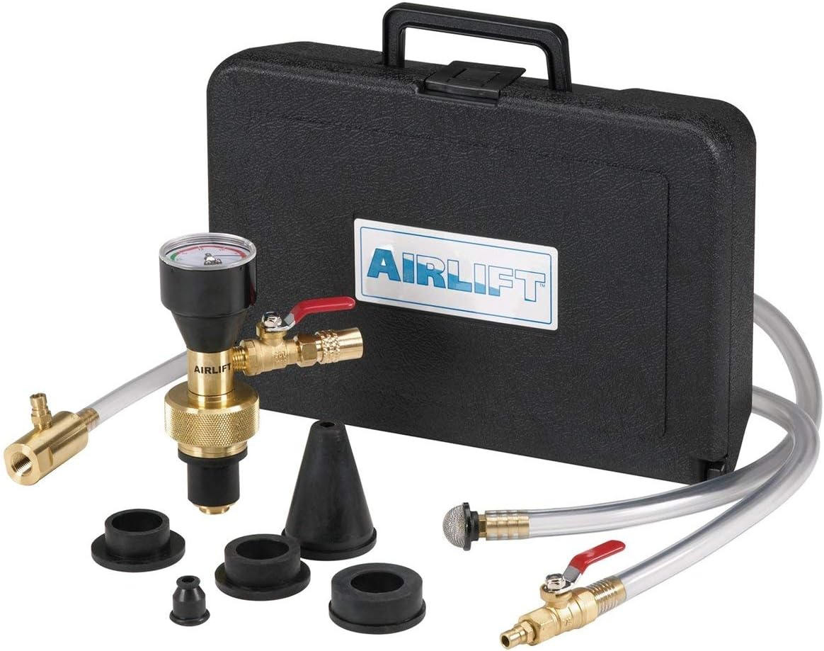

Happy Holidays all!! Going to fill coolant sys with vacuum tool. Some say pinch 2 lines going to filler cap in trunk....others don't mention it. Also.. what to do with bleed valve open or closed during vac process. Thanks V

There is no reason or need to pinch any hoses while using the vacuum filling system, and the bleed valve should be left closed during the process.  Simply mix the coolant with distilled water in a 5-gal bucket, drop the pickup tube to the bottom of the bucket, pull about 24-28 inches of vacuum on the system, then slowly open the valve to allow the coolant to be drawn in.
One of the biggest advantages of the vacuum system, besides speed and completion of a fill without any air pockets, is its simplicity. About 4-5 min after opening the valve to let the coolant flow, you are done.
Ummm... after 4-5 min open which valve. Air bleed valve?

Well of course its never that easy. Attached my vac.tool(its a knockoff from ebay) Somehow I can't draw vacuum on the coolant sys. I'm I missing something here? Did same in video except going off the expansion tank in engine bay. All hoses reattached and clamped, valve nice and tight in expansion tank. I removed the tool and attached shop air and plugged suction hole and it drew vacuum......it just doesn't work when attached to expansion tank. I had my compressor up to 120psi and just shut it down and connected to venturi. Should I have left it on so it would just kick in while connected to venturri.....didnt think I needed that much compressed air but maybe thats what my problem was. Thoughts?
Edited by vza
Depending upon how big (capacity) your air compressor is, it may take some time for the vacuum to develop due to the volume of air it has to remove. Ideally, you need about 90 PSIG of pressure to make the system operate correctly.  The only other possibility is something is open in the cooling system; if you have a cooling system pressure tester, it might be a good idea to try pumping the system up to around 18 PSIG and see if it holds.
When we use the Uview unit, it starts to pull vacuum pretty quickly once the compressed air is started.
Yeah I figured as such....2.5 HP 20 Gal. I'll give it another go, see what happens. Like I said I did it with the compressor off, so it definitely fell well below 90PSI while connected.    Thanks V

Did the best I could adding coolant with vac sys. I wasn't able to completely remove air from the hose when priming it with coolant so some air got in the system. (air bubble in coolant pick up hose)I ran the car at idle for half hour got a blinking light for low coolant kept revving and adding coolant with the bleeder valve open couldn't get the light to stop. Another thing .....my temp gauge didnt budge and heater is blowing cool air. Then my AOS failed....bellowing white smoke. Ugh.
