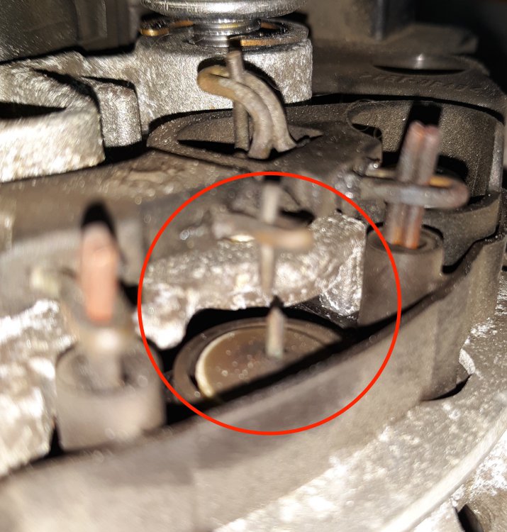

Managed to get my alternator out and I think I need more than Voltage Regulator. I noticed 2 wires burned up(pic of 1 of them) I guess these are wires to the Diodes. I did smell some electrical burning when test driving .....maybe the alt?  Would it be okay to use an alternate reman alternator ie.AC Delco. They are less expensive than the Bosch. Thanks V
