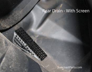

Good luck and when you are paying for the new unit, remember that Porsche sells a $20 part that prevents this from happening:

The problem with the convertible top well flooding has been well known and documented since the early 2000's.  The well under where the tops stores is well designed to collect water and funnel it to the two drains that drop it under the car.  Problem has been from day one that these drains quickly become plugged with grass clippings, leaf debris and the like, resulting in the well becoming flooded.  When the car is in motion, and the brakes are applied, a wave of the trapped water sloshes over the well lip and directly under the driver's seat where the central locking module lives.  Around 2001-2002 Porsche realized there was a significant problem (due to the number of modules they were replacing under warranty) and released the specially contoured screens to protect the well drains.  Having installed a ton of these screens, you would be amazed at how many cars had either one or both drains completely plugged, and even had standing water in the wells.  The preventative fix is simple: Clean out the drains with compressed air and/or soapy water, then plug in the screens.  Problem solved, I have had them in my personal car since they were released, and drains have never needed cleaning again................😉
