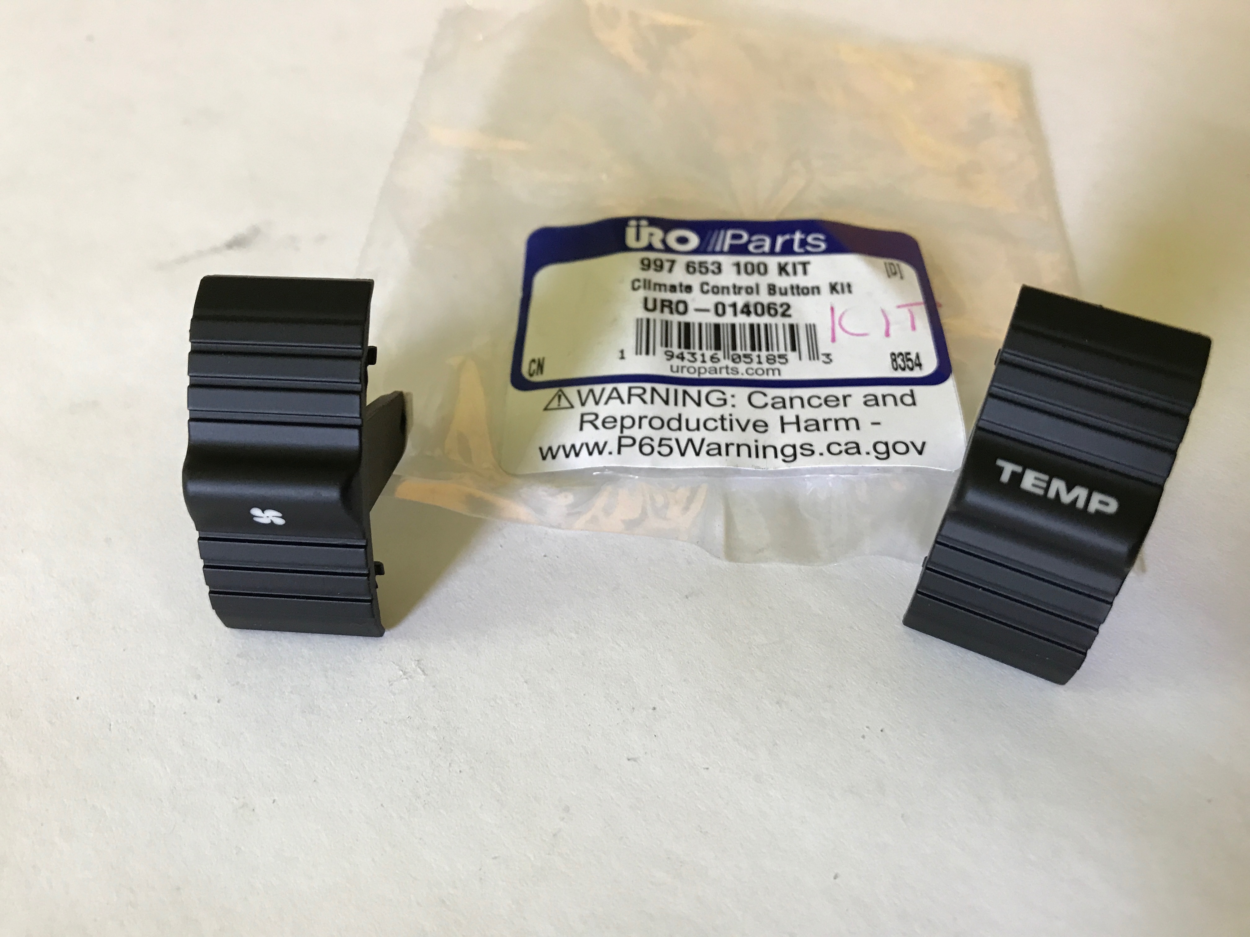

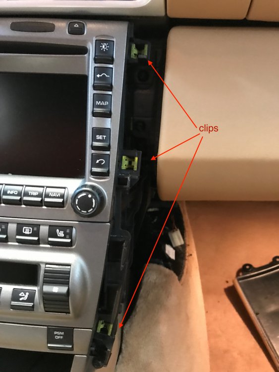

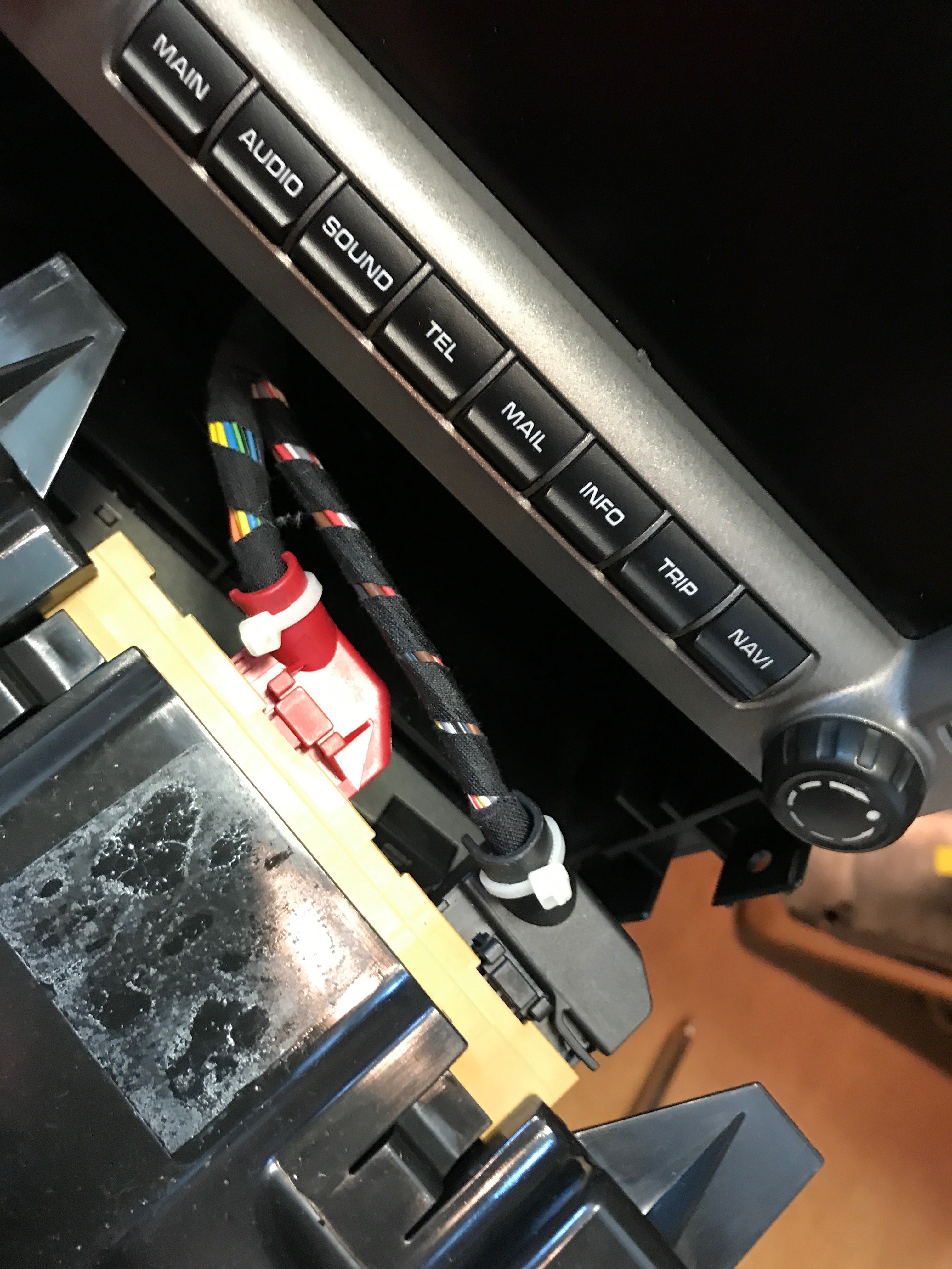

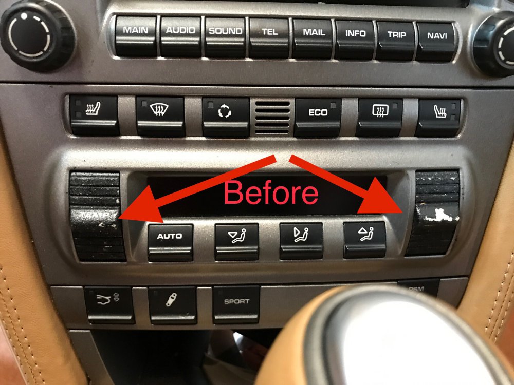

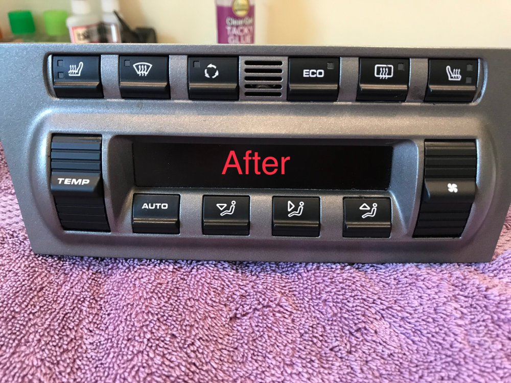

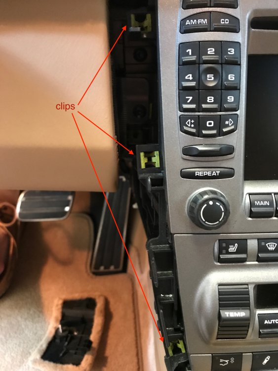

so looking to replace the ac switches so I have to remove the right and left trim pieces that house the unit, then the unit. does anyone have a pdf I can download for directions for the entire process?  I thought I had a good idea but then the tech at the dealer said there is a sub woofer in the passenger side footwell I wasn't counting on.....

Ok, found a YouTube video with the wrong equipment but I figured it out.  Basically the same less the footwell passenger grill....

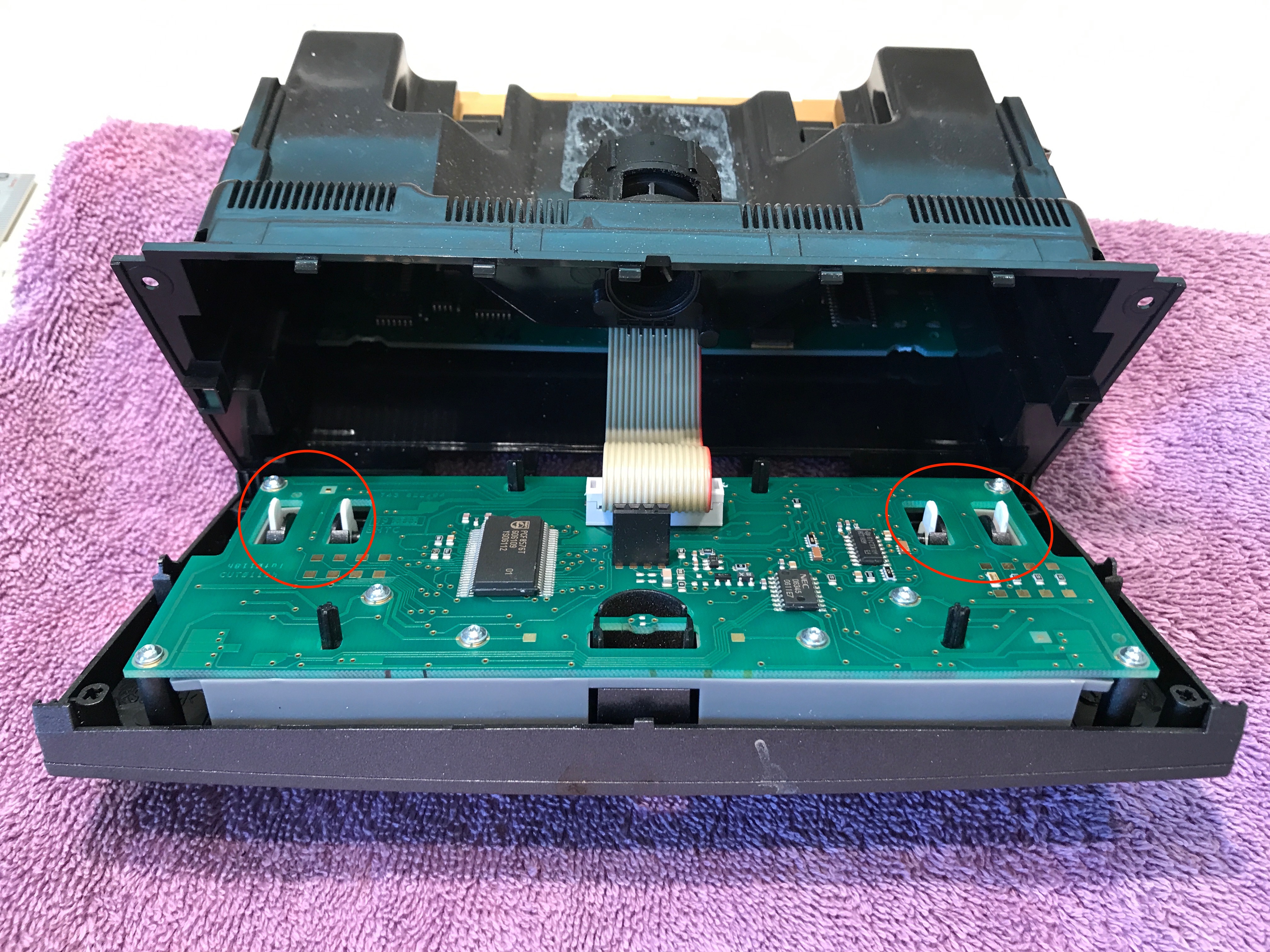

backside of switches
