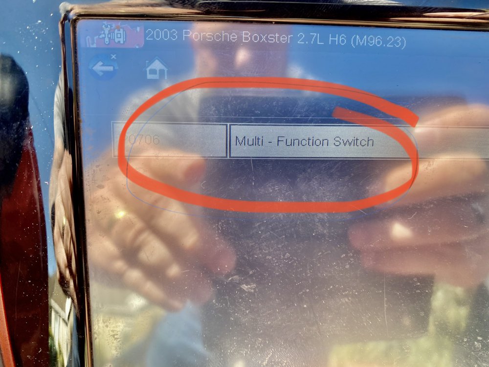

I’m getting a flashing red light between 4 and D when driving and it won’t move into manual? Is this the transmission multifunction switch? Plugged in obd 2 reader and it’s not giving any fault codes whatsoever
Yes this is limp mode / telling you there is a problem. You’ll need durametric or the actual Porsche system tester to see the transmission fault codes.
That’s great but you might want to look into why the code was triggered. I didn’t know the snap on tool would read transmission codes!
Seems as when my battery went flat recently there were a number of codes present
all cleared and fingers crossed it’s sorted itself out
new battery for sure ! The one on there doesn’t seem man enough
P0706 is for an implausible signal from the multifunction switch, usually a discontinuity.  Typical faults:
  1. Wiring problem
  2. Multifunctional switch failure
  3. Tiptronic control module
