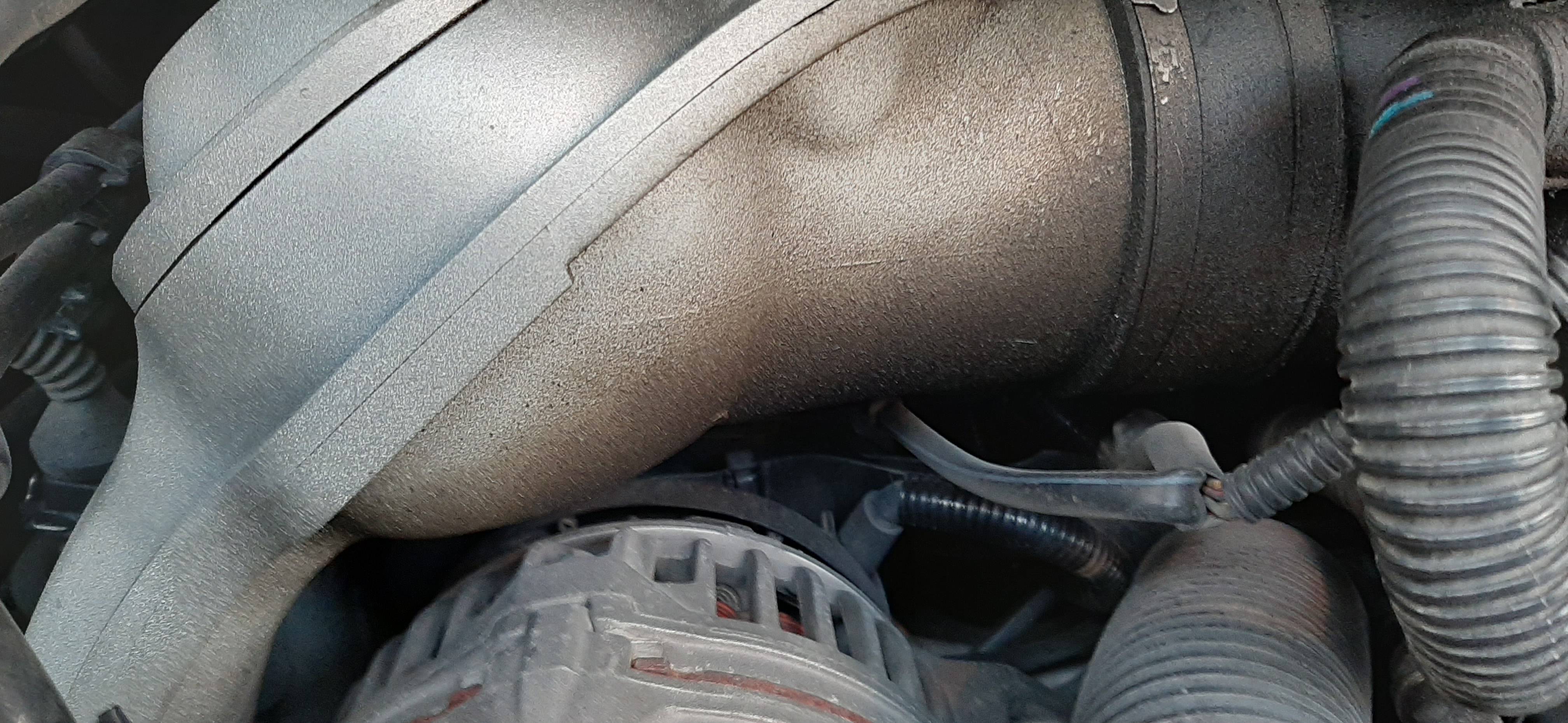

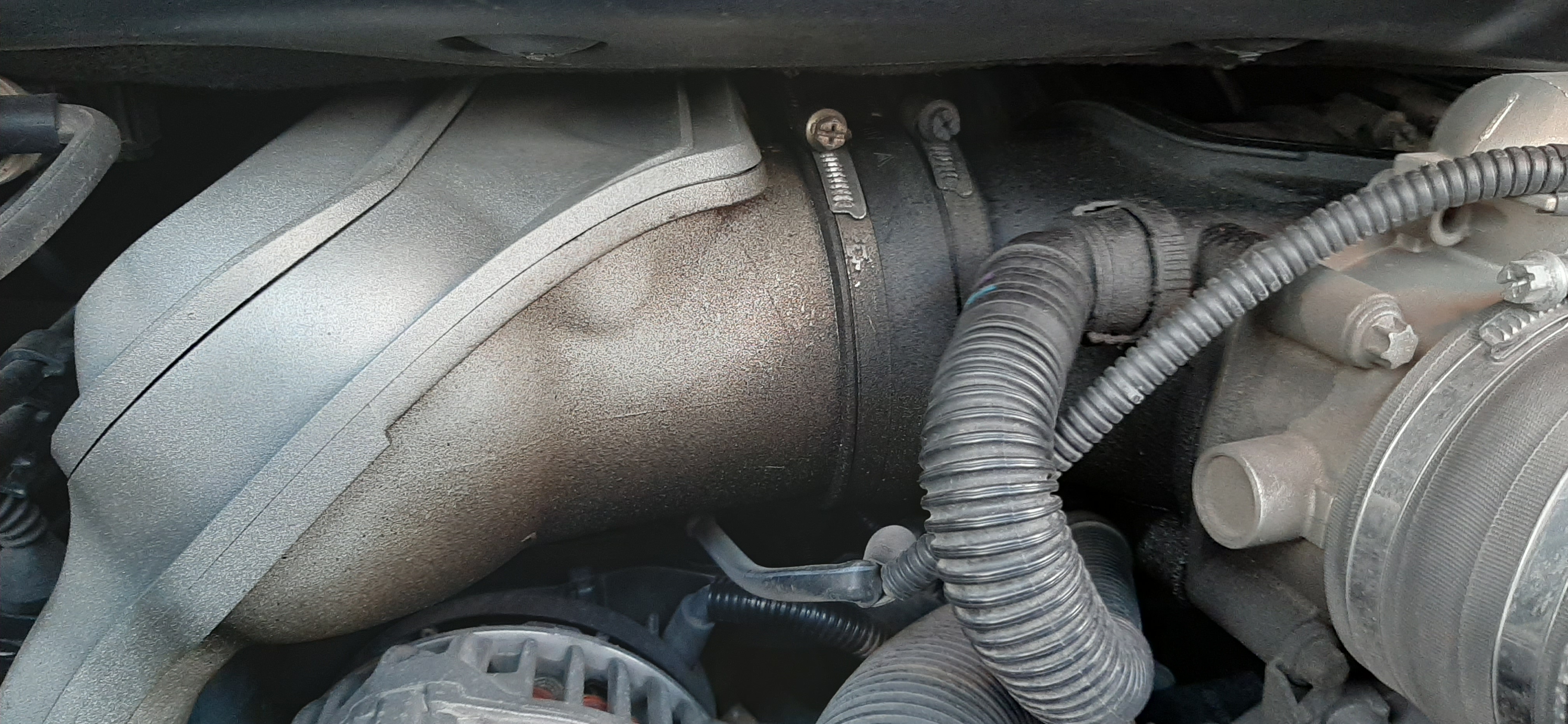

I was over at my friend's place yesterday and ran my code reader on it again after some codes popped up again. It looks like he has two less codes on the Readiness cycle since last week. All that is left stating "Not Ready" is the Evaporative System and Secondary Air Injection. I don't know his 997 or my own 991.1 GTS like I know my 993 (like the back of my hand).
I had a quick look in his engine compartment and this is what I noticed. Nice that you can see an engine, unlike my 991.1.
Notice the damp oil residue at the intake plenum and throttle. Time to take it apart, check seals and the AOS.
