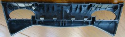

As I do more mods I find that having a picture of the back of a trim piece helps a lot in trying to figure out where to pull, snap, pry, etc. I got my new batwing today so I'm including a pic of the back, maybe it'll help someone when they are doing their own projects:
Alex
