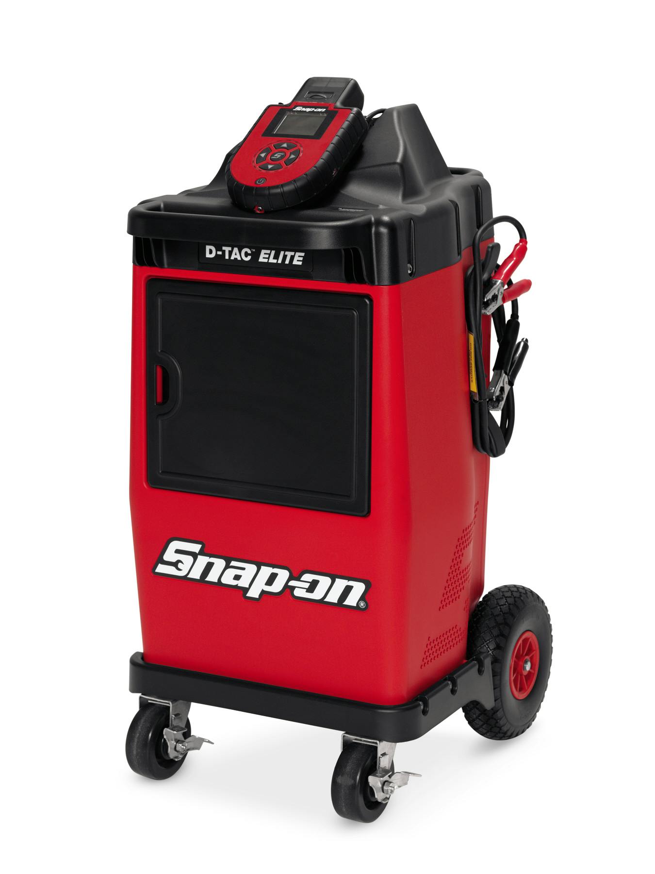

I would not bet on that, modern load testing equipment can load test the alternator in the car, and can even test the diodes' with it in there.  Units can be pricey, often $4K (US) or more, but will test the entire system.
