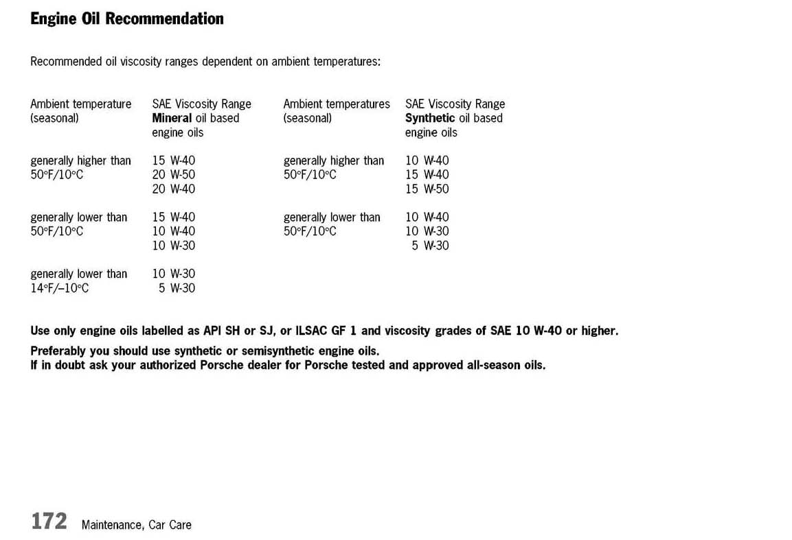

Where did all of you see Mobil1 0w40 in the users manual.
Page 172 attached.
"use only engine oil...and viscosity grades of SAE 10w-40 or higher. Preferably you should use Synthetic..."

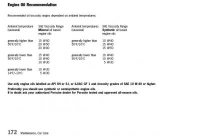

Page 172 attached.
This will vary depending on the model year. For instance, my 1999 Carrera says to use 15W-50 Mobil 1.
There is an official "Approved Oils" TSB from Porsche (that is updated every year) that states Mobil 1 approved oil is 0W-40. That TSB also has 8 pages of approved oils from many companies. Contributing Member can view that TSB (as well as others) here online.
