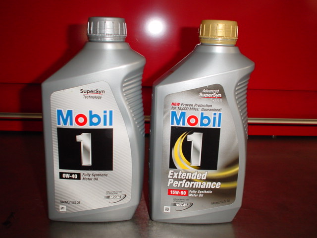

O.K., so I did some more research on the oil I currently use and then the one rec'd by Jim (50W) and below are the data for the oil respectively. Can anybody please interpret some of this so I can understand it in "plain English"? After all the reading I have done, I am still stumped. Thanks to Jim for the links.....very informative.
MOBIL 1 0W-40 // MOBIL 1 EP 15W-50
Viscosity, ASTM D 445 // 445
cSt @ 40º C 80 // 133
cSt @ 100º C 14.3 // 18.2
Viscosity Index, ASTM D 2270 187 // 153
Sulfated Ash, wt%, ASTM D 874 1.2 // 1.42
HTHS Viscosity, mPa·s @ 150ºC ASTM D 4683 3.6 // 4.43
Pour Point, ºC, ASTM D 97 -54 // -42
Flash Point, ºC, ASTM D 92 236 // 241
Density @15º C kg/l, ASTM D 4052 0.855 // 0.866
Thanks again!
Edited by LVDell
Dell:
The "High Shear" viscosity number is the one that actually correlates with oil film thickness on your bearings at operating temperature. The 0W-40 only has a shear rating of HSHT value of 2.9 cP at 150ºC . 15W - 50 has a HSHT value of 3.7 cP or 27% more viscous oil at 150ºC .
As a matter of fact, Mercedes-Benz recommends use of ONLY Synthetic Motor Oil that is at least SAE 5W-40! This is a recent increase in recommended viscosity from SAE 5W-30. Apparently customer research indicated that engine longevity is more important to typical MB customer than fuel economy.
Any of the quality oils with weights of 0w -40 will give you the protection you need in the short run and probably an unmeasurable increase in fuel economy. However, for long term protection of the bearings, a 10W or 15W - 40 or 50 should prove better. In your case, since you do not have any bitter weather like hear in Chicago, I see not downside up moving up to a higher viscosity.
I really believe that the 0W oil is a fad and, like Mercedes, it will be found that a higher shear viscosity and the longevity it provides the engine will outweight the fuel economy.
Looks like a switch to the EP line is where I need to be to get the 10W-40 or 10W-50 oil since i can't get ANY of those combo's in the 1 line. Concur?
