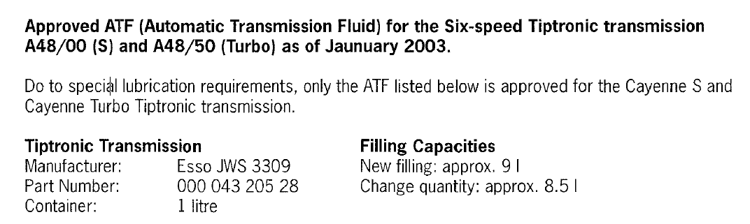

  On 9/6/2020 at 5:59 PM, Loren said:
I think it is still best to stick with approved ATF oils. Esso should be available at much lower than Porsche OPC costs.
Expand

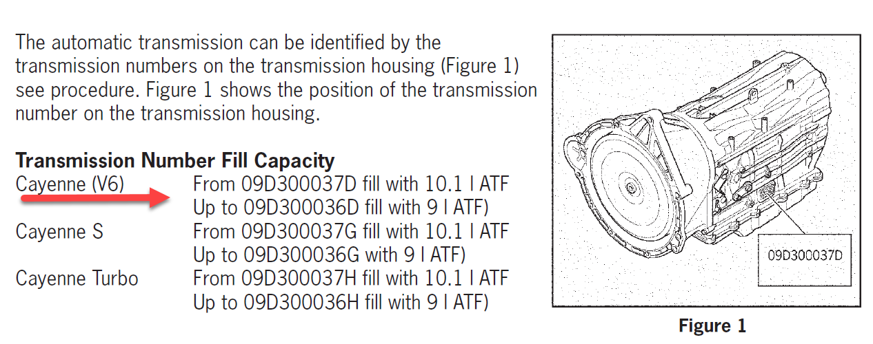

Hi Loren
thats for Cayenne S and Cayenne Turbo
ive got the lowly Cayenne 3.2 V6 🙂
so is my ATF different??
Mobil ATF 3309 is recommended for use in transmissions requiring fluids of JWS 3309 or GM 9986195 quality levels.
AISIN Automatic Transmission Fluid Type T-IV (ATF-0T4) JWS3309 (AISIN is the OEM transmission for Cayenne)
Volkswagen and Volvo also used these transmissions so they should sell the ATF also.

Ok so the MOBIL ATF 3309 should be ok correct??
and your saying AISIN also as that was the original Fluid in the Cayenne transmission?
  On 9/6/2020 at 6:24 PM, Loren said:
Yes, AISIN is the manufacturer of the Cayenne transmission and the original fluid.
Expand
Ok cool
and one last thing MOBIL IS Esso in the UK so the MOBIL ATF 3309 should be good correct??
