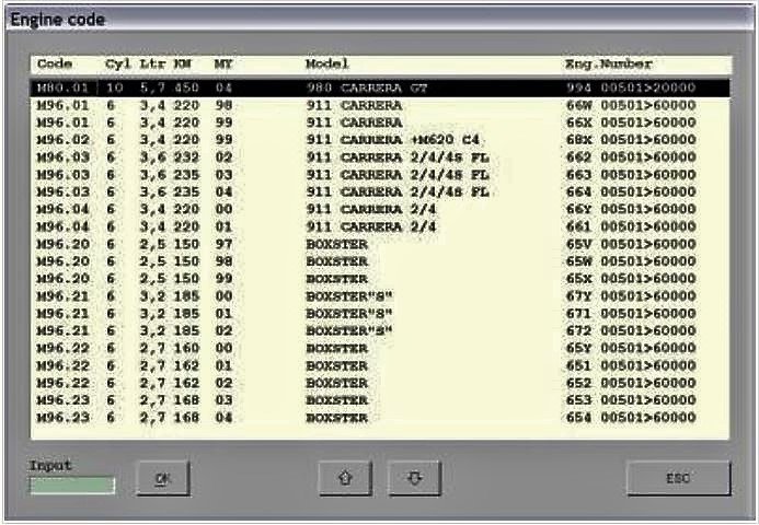

Here's the engine # M96/J466Y14721.  Seller says build date 4/2000.

I don't understand that engine number.  Here are examples of engine numbers:

Here is my 99 Model Year M96/01 engine number.  Per the above chart, a 2000 should have an engine number M96/0466Y....
Thank you for your reply and the engine number chart. Agreed, the number provided by the seller is incorrect, and the photo provided is not a clear shot. The 'J' could well  be a '0'. The first setp in a PPI would be to clairify this. Let's assume for the moment that the correct number is M96/0466Y14721. How does this relate to known information on the IMS? Again, thank you for your time.

Your engine number is M96/04  66Y 14721

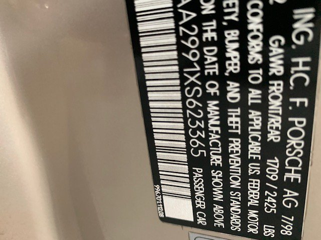

One thing that would be helpful is a picture of the door frame sticker that shows the actual date of production.  For instance, my car was sold as a 1999 C2 coupe, but was made 7/98. Maybe you can get that during the PPI
Thanks. I'll see if I can get the door sticker pic today. Seller says build date 4/2000. Does the information provided thus far get you to the IMS information?
