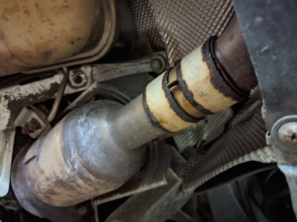

Ok guys I'm back, sorry for the delay I had to wait until I was in the right mood to do this. I dropped the oil and filter, and... no metal. I ran it through a strainer too. So I'm like, did I overreact or not? Changed oil and filter. Went to start it, but didn't hear fuel pump, so I jumped the relay. But alas, no start. I think we can rule out the fuel pump because it didn't start while jumping it. Also the relay is probably good but the system wasn't calling for fuel? Has new coils and plugs and ran good like that til it died. So I made a video:
 Also, theres some liquid dripping from this clamp on the cat. Maaayyybe oily? Kinda watery. Not sure if its related. Also what's up with that flashing temp light? What do you think and thanks for the help.

Considering it is a 2.5, you may have "D-chunked" the engine cases.
Before doing anything, you need to confirm what is actually wrong (e.g.: Bore scoping/compression testing/leak down testing cylinders 2 and 5, the ones the commonly D chunk, pressure testing the cooling system to verify you have a leak, dropping the oil and looking for presence of coolant,. etc.).  If you have then confirmed the 2.5 is toast, you can sell the car as a "roller" for someone to undertake as a project (late model Porsche's with dead engines still have substantial value).  Scrapping the car without confirming the engine is gone would be both foolish and a financial loser as a replacement engine can be sourced from a wreck for a few thousand dollars.
