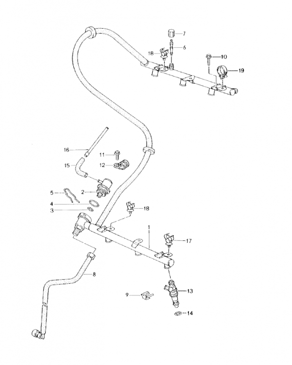

Diagram

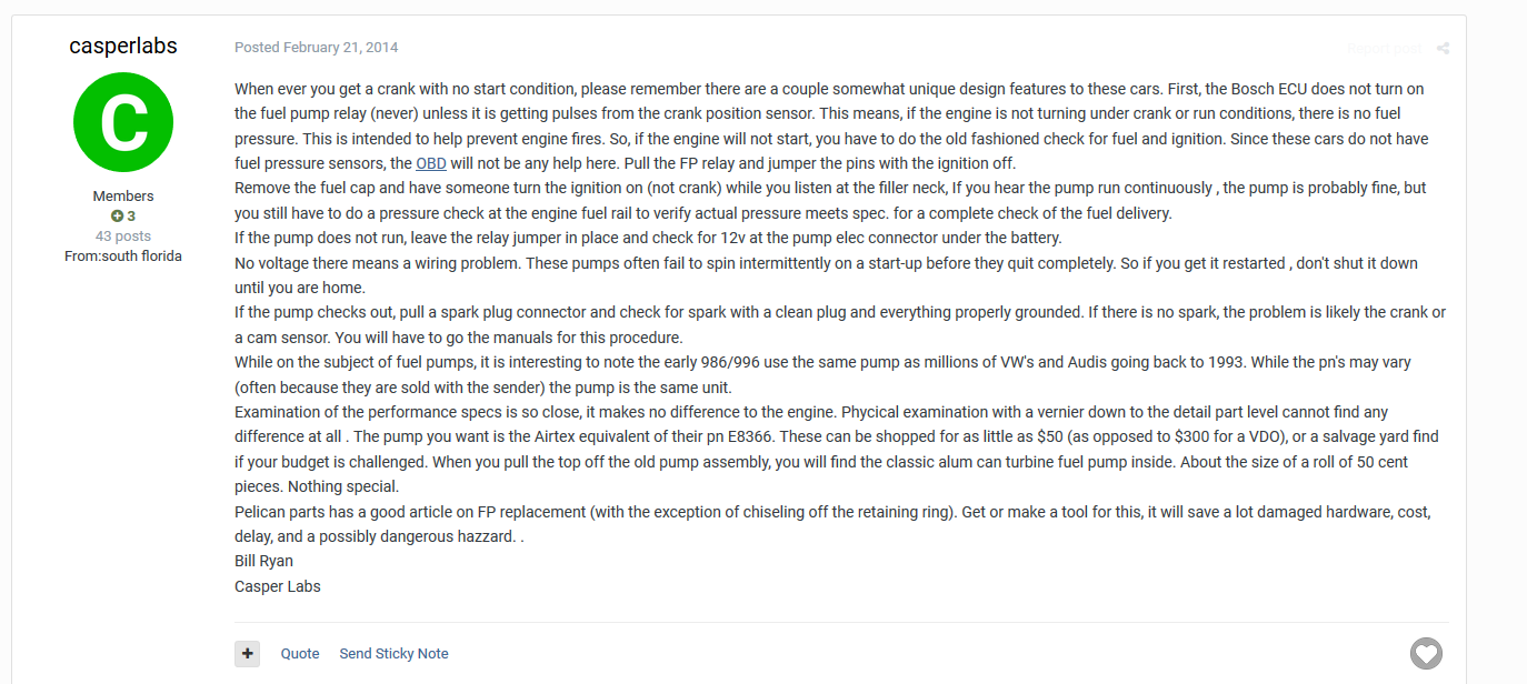

I can't remember what thread this was on here, but I saved an image when I was working on it.
Edited by crwarren11
After replacing the fuel pump it was obvious what the noise of the fuel pump running was supposed to sound like.  Since this was my first fuel pump job, I never knew before, but it is a very distinct noise you can hear either from the area under the hood near the battery, or some have suggested listening into the fuel filler with the cap removed.  To me it is a buzzing noise, kind of like one of those small drones makes (like the ones you would buy for a 5 year old, not the big ones for us adult children).  I did all the jumping methods for the relay, etc. and never got the noise.  Also tested the pressure at the schrader valve, which was 0 at all times.  What threw me off initially was that I kept reading the telltale sign of a bad crankcase sensor was that the tachometer would not bounce when trying to start.  Mine did not, so I thought that was it.  As I mentioned earlier, my sensor was fine.  Hope this helps...
