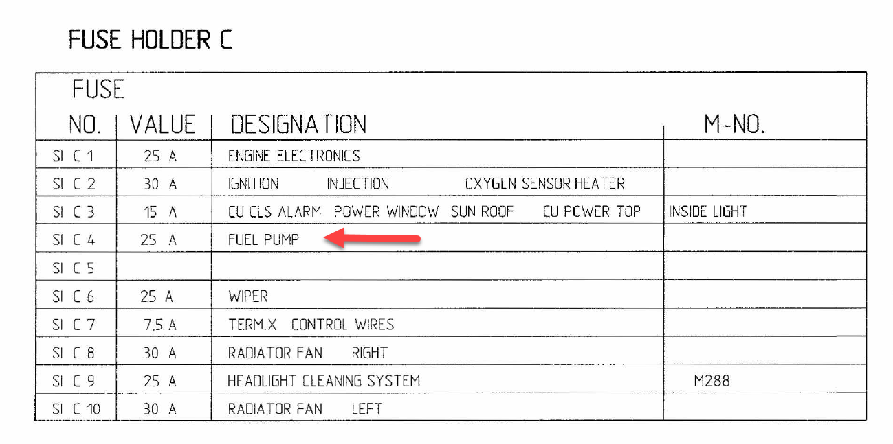

Thanks that is what I thought however the fuel fuse (position C4) is a 30 amp fuse so I am wondering if my relay jumper fuse should be 30 amps instead of 15 . Maybe the fuel pump when it intially tries to start is drawing enough current to blow the 15 amp jumper fuse ?
cheers
Thanks Loren. According to the Bentley manual the fused rating was 25 amps up until 2000. It then changed for 2001 - 2005 models to 30 amps.
So I guess I assume that the relay jumper doesnt need to be fused ?
