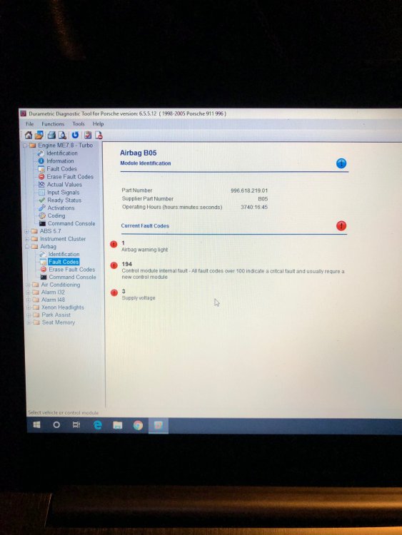

I picked up an 02 996tt a few months back. The airbag light was on when I got it. I finally had a chance to hook up the Durametric scanner. Below are the current fault codes and they cannot be erased:
1 - Airbag warning light
194 - Control module internal fault - All fault codes over 100 indicate a critical fault and usually require a new control module
3 - Supply voltage
Will a new or repaired control module fix the issues? Appreciate any input.

It's a real Durametric. From what I've been reading, seems like airbag codes over 100 are hard codes and can't be erased. I will give it another try tonight. I attached a photo of the readout. Thanks!

Checked the fuse last night and it was good. Ran the Durametric again and could not erase the code. Looks like it's a faulty control unit. Can I get a used one? Is it simple plug and play or will it need to get reprogrammed?
Changed out the airbag module and the was able to clear all the codes on the new module with the exception of code 72 (child seat detection). The dealer said they should be able to address that code with their computer.
