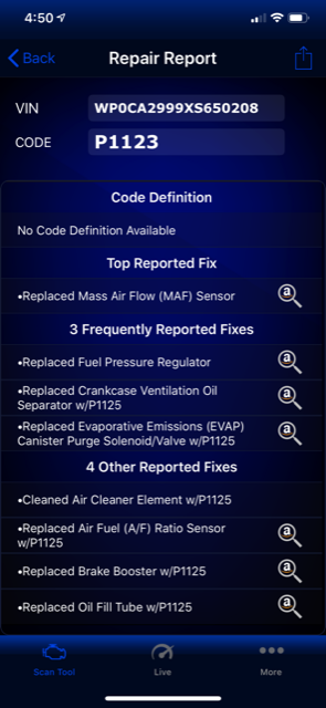

Thanks.  I have the Bluedriver diagnostic tool and their top rated fix was to replace MAS.  Next they have replace fuel pressure regulator,  replace crankcase ventilation and replace EVAP.  See picture attached.
Any ideas of next best steps?

I'd start by checking the fuel pressure, then looking at the EVAP purge valve (they can often be cleared with a quick blast of compressed air).  I would also look at the fuel trims.   I have no idea why they list the MAF, it is not even mentioned in the factory OBD II manual for the car decision tree for diagnosing the codes.  Once of the biggest issues with a generic OBD II scanner is they often list fixes that may have worked on a Ford Fiesta, but totally do not pertain to your Porsche. For example, while they do point out valid possibles, I have no idea how replacing a brake booster is going to help an overly rich A/F mixture issue...………..

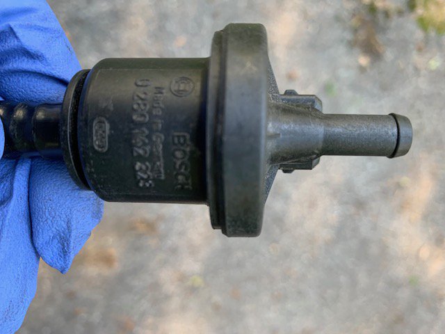

I blasted the EVAP purge valve i believe - see pictures from left top of engine bay (i dont think it did anything).
Not sure how to check the fuel pressure.  I notice at idle the RPMs surges up and down a bit around the 1000 mark, but once moving the car seems to be running well.

Does that purge valve stay closed (hold vacuum or pressure)?  You check the fuel pressure by attaching a fuel pressure test gauge to the test port on the fuel rail, and then check your pressures running and shut off.  Can you use your OBD device to read fuel trims?

Update - i reset the code after blowing out the purge valve and the check engine light has not come back on yet.  Keeping my fingers crossed.  I ordered one off ebay for $45 as a backup which is much cheaper than taking to Porsche for diagnostic.
