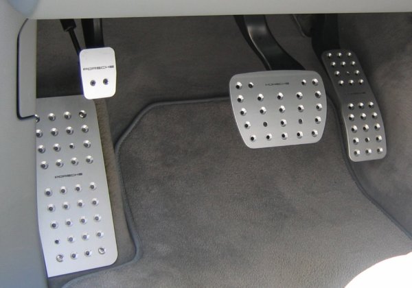

FYI, my search for a dead pedal resulted in a full replacement with aluminum, and at a very reasonable price. I had seen a four piece set of aluminum pedals on eBay, and the price recently dropped so I snagged them: http://cgi.ebay.com/ebaymotors/ws/eBayISAP...TRK%3AMEWN%3AIT I'm sure they'll put some more up, and they do have them at their store at http://www.luxwheelsandaccessories.com/Mer...Category_Code=C though the shipping is higher with a direct purchase.
Comments: So far, so good, quality looks ok, there were some minor installation issues. First, the brake pedal curvature does not match up perfectly with my '04 Cayenne pedal, but it was close enough to do the job. The remaining pedals fit was ok, though the brake release is also not a perfect fit, but that's no biggie.
A pack of black bolts, split washers, and nuts is included, but they are not sufficient to mount the pedals. The screw locations designated on the pedals can hit a place where the brackets are located in a couple cases, so the bolts are too short. The accelerator is plastic with a honeycombed construction, so it also requires more lengthy bolts (not by much), and a second, larger washer can be a good idea. But in the grand scheme of things, it's no big thang.
They provide black double faced adhesive pads to mount the dead pedal plate -- I elected to use four short stainless steel screws, which seem to have a good hold in the plastic/carpet section beneath it. We'll see.
In any case, they look very sharp, and I'm happy to finally have something in place of the perpetually dirty Porsche plastic rectangle.

Don't let my comments above scare you off, I just wanted to be very precise regarding their fit. The "mod" consisted of me going around the corner to the local hardware store and checking their aisle with all the nuts and bolts in little drawers. I spent about $2 on two sets of slightly longer stainless steel longer bolts, nuts, and washers, and four ss screws. Installation, in total, took about 15 minutes. I've since driven with them and they are very solid and I don't expect any problems with them.
