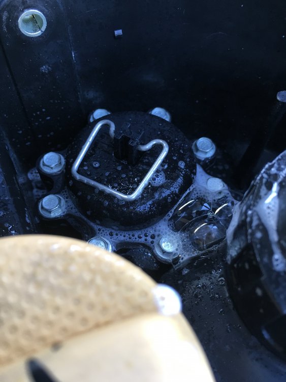

Right now I am experimenting with the pressure tester. I pumped the cooling system up to 15 psi and as the pressure increase, the coolant level in the tank decreased. Is that normal?
It started loosing pressure slowly but it looks like the pressure is escaping the bleeder valve. The metal pull tab isn’t doing anything because the pressure is causing the valve to pop up automatically. Is that normal?
Seems to have leveled off at about 12 psi and not loosing pressure any further. When I let the pressure out, the coolant level comes back up and the bleed valve closes. Upon adding pressure again, the coolant goes down. Looks like the bleed valve starts to open at about 4 psi.

Right now I am experimenting with the pressure tester. I pumped it up to 15 psi and as the pressure increase, the coolant level in the tank decreased. Is that normal?
You need an air compressor to operate the Uview and create vacuum.
If you pressured the tank and the level dropped, you just proved you have air in the system.  Air is compressible, coolant is not, which is why the level changed.
The system should hold pressure at 18 PSIG, if it drops lower, it is leaking.  Bleeder valves are known to do this.

2. Bleeder valve... I could actually see air bubbles coming out the bleeder valve between the top half and the bottom half where there screws are. What would be the fix for this?
1.  The answer is no.  As long as the vacuum tool is above the liquid level, it will not pull coolant out.  I would suggest bringing the vacuum level up slowly as the system will "burp" which could splash coolant onto the vacuum unit.
2. The bleeder has O-rings on it that can be replaced, and you can buy a complete new unit as well.  DO NOT use aftermarket pieces, they have proven to be of poor quality.
The two screws near the leak seemed a bit loose. I tightened up the screws a bit and the leak seems to have stopped and holding pressure.
