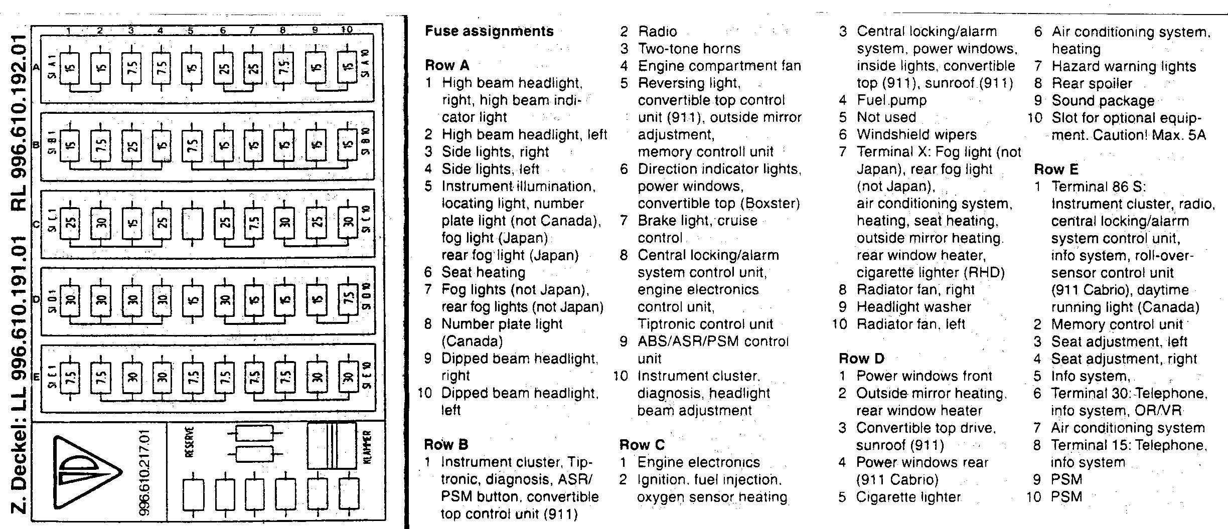

I don't think a 99 996 has an alarm siren.  When the immobilizer is set off, it just beeps.  Are you sure there isn't some aftermarket alarm on the car.  A beep when  locking the car means a zone is open somewhere....hood, engine lid, console lid, fuel filler door, doors, overhead infrared sensors, and if you have it the glove box door.  If the car is unlocked and thus the immobilizer is not set, and yet the alarm is going off you have a problem.  Pull the fuses for the alarm system B8 and C3
Edited by DBJoe996

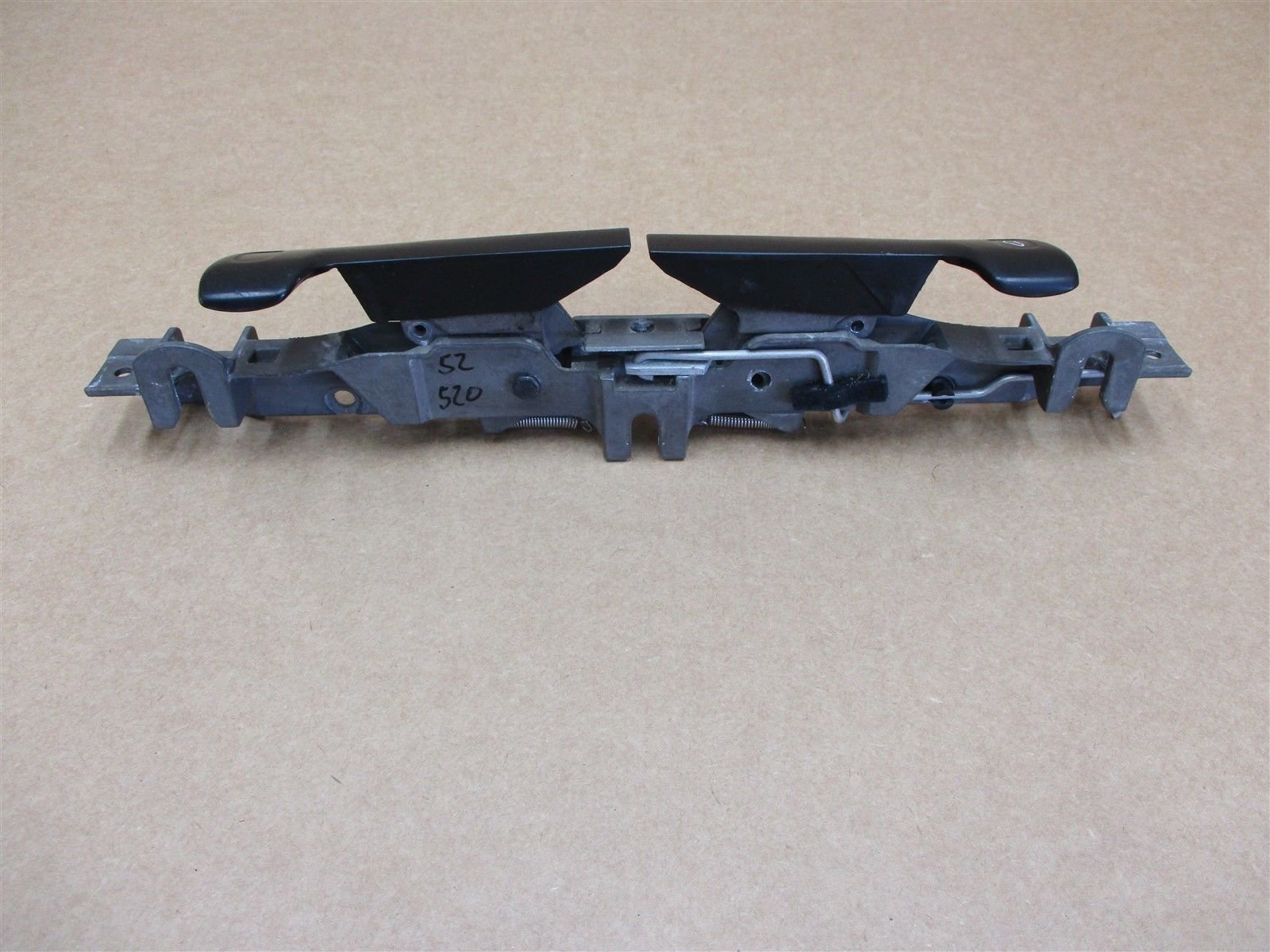

2. I have one beep when I lock the car and as stated above it means one zone is found open. Apart from the already mentioned ones there are two more (as I learned over at rennlist.com).
One is the switch behind the OEM radio that breaks the circuit as soon as the radio is pulled out or its connector pulled off.
Apparently isolating the/a brown ground wire and leave it disconnected solves that when fitting an aftermarket radio.
The other 'zone' is the actuator that locks the manual levers to open trunk and engine lid when locking the car using the remote.
I found in my 99 Carrera 2 that the locking actuator was not fitted and it looks it never has been as the actuating rod and associated plastic clips n guides are absent too.
Looking at 2nd hand parts online I am not sure every 996 up to 00 came with this actuator even though the parts catalogue states so.
See pictures below for the associated parts.
A way to check whether that is the open zone is to open the trunk, push its lock to the closed position using a screw driver, get access to the battery poles, lock the car via the remote. (You should get a single beep if you successfully locked the trunk lock else two beeps)
Disconnect the positive battery wire, open the car with the key and pull the trunk lever. If the trunk lock snaps open then you either have no actuator locking the levers or it is broken (in the open position) and the single beep stems from it being broken.
Cover removed from sill (on LHD car) yellow lines mark locked and open position
The actuator fits on the right side of the alloy bracket.
Being a UK car it has to fulfill Thatcham anti-theft requirements which probably had porsche fit the siren and tilt sensor shown above that is different from RoW vehicles.
