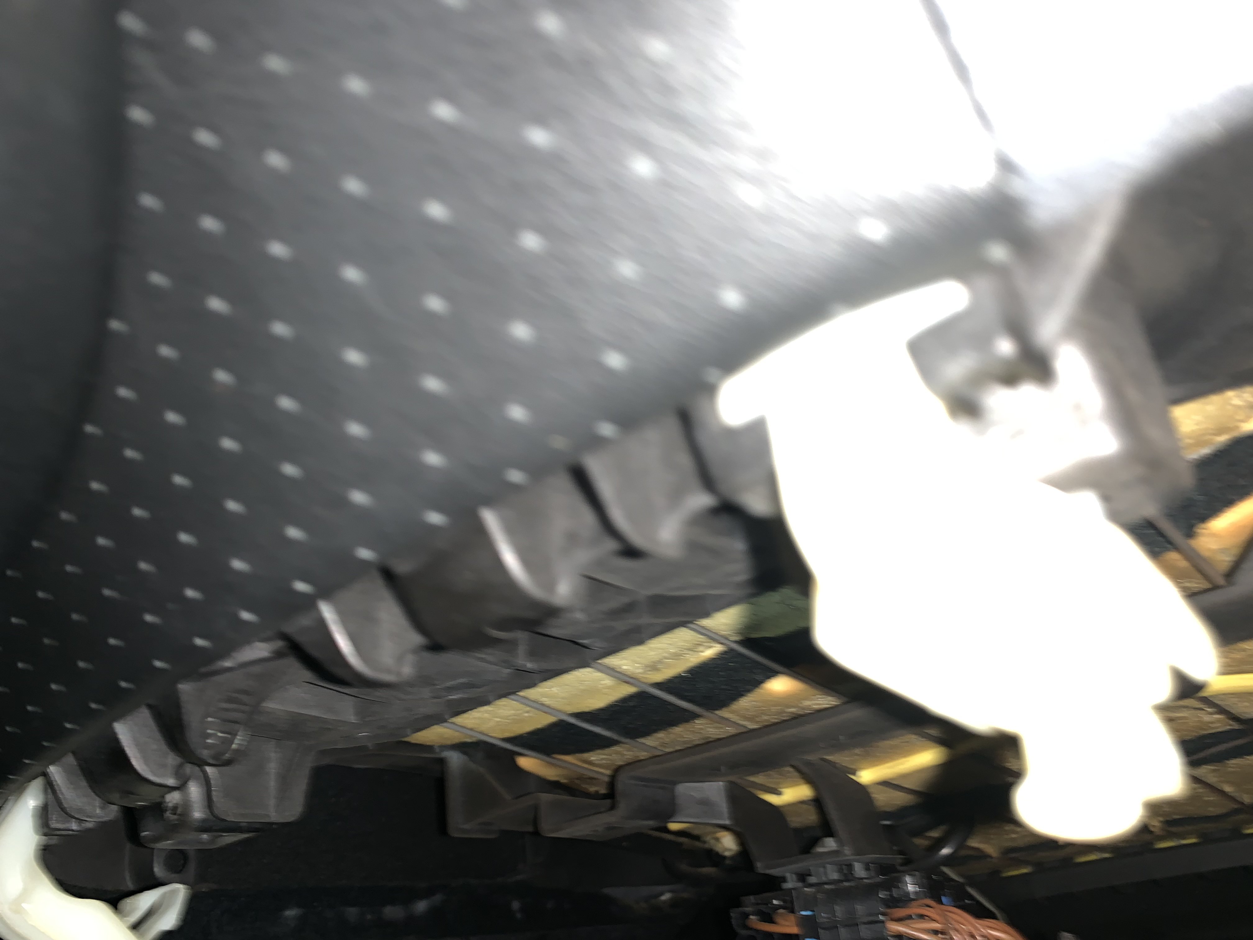

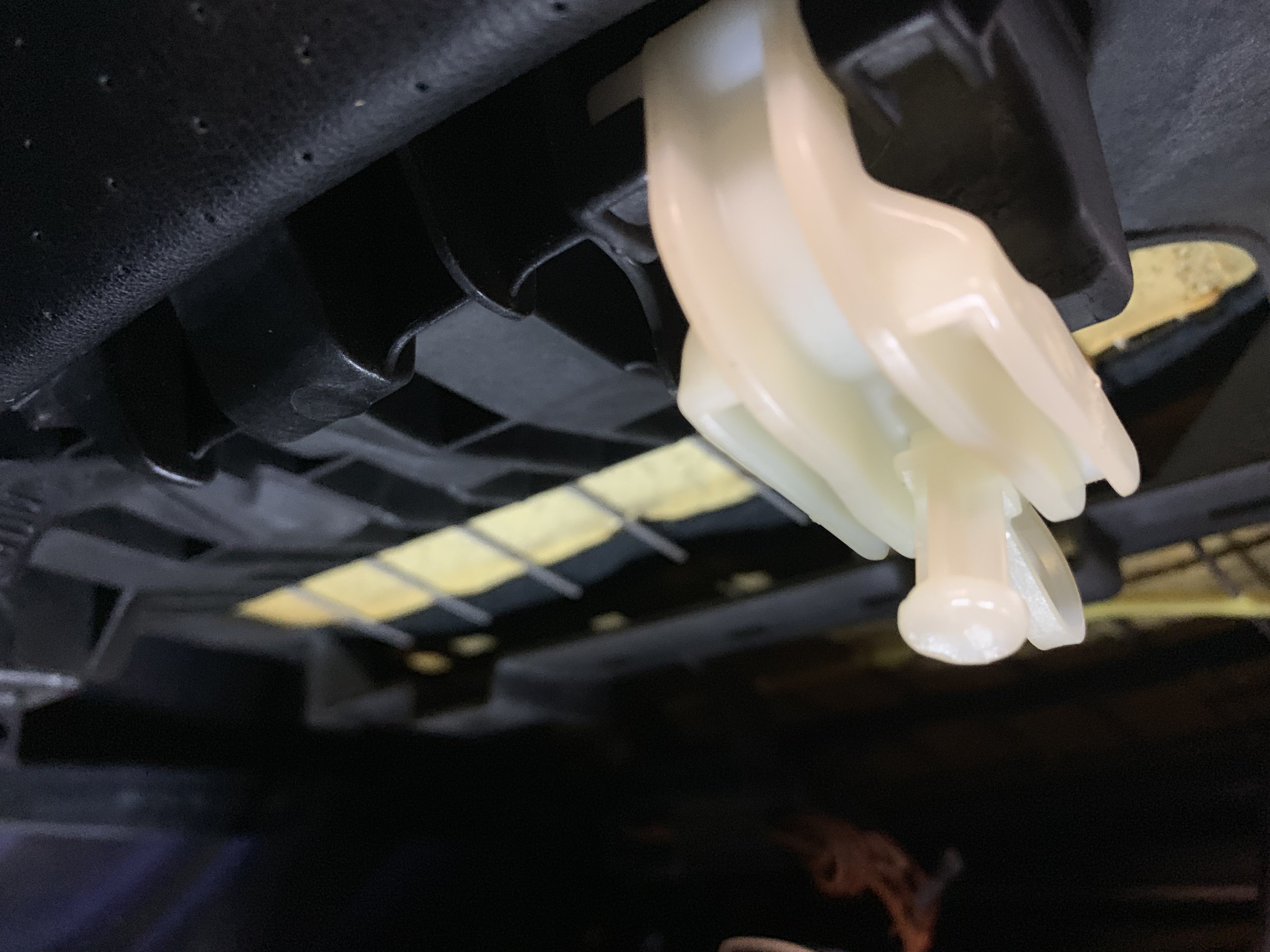

Unfortunately the drivers seat is problematic.  There are the seat switches for moving the seat, the memory switches on the door sill, and the seat memory module under the front part of the seat.  There is a mass of wiring under the seat.  More than likely the wiring under the seat is shorted because one of the wires got caught in the seat rails.  And...if it is blowing the seat fuse then bonus...you cannot move the seat to access the bolts to remove the seat to check underneath.  First step, reach way under the seat from behind and feel the wires and move them around.  I know this is blind but simply moving the wires may eliminate the short.  Then, if this fails, you need to lift up the seat bottom.  There are two white plastic clips under the front of the seat.  You pull down the pins and that releases the white clips that hold the seat bottom on the seat rail.  Then you carefully lift up and pull forward the seat bottom.  Careful here because there are wires attached to the seat bottom.  You want to just prop up the seat bottom to expose the wiring underneath.  Then you will have to see if you can find where a wire is shorted or stuck in the seat rail.

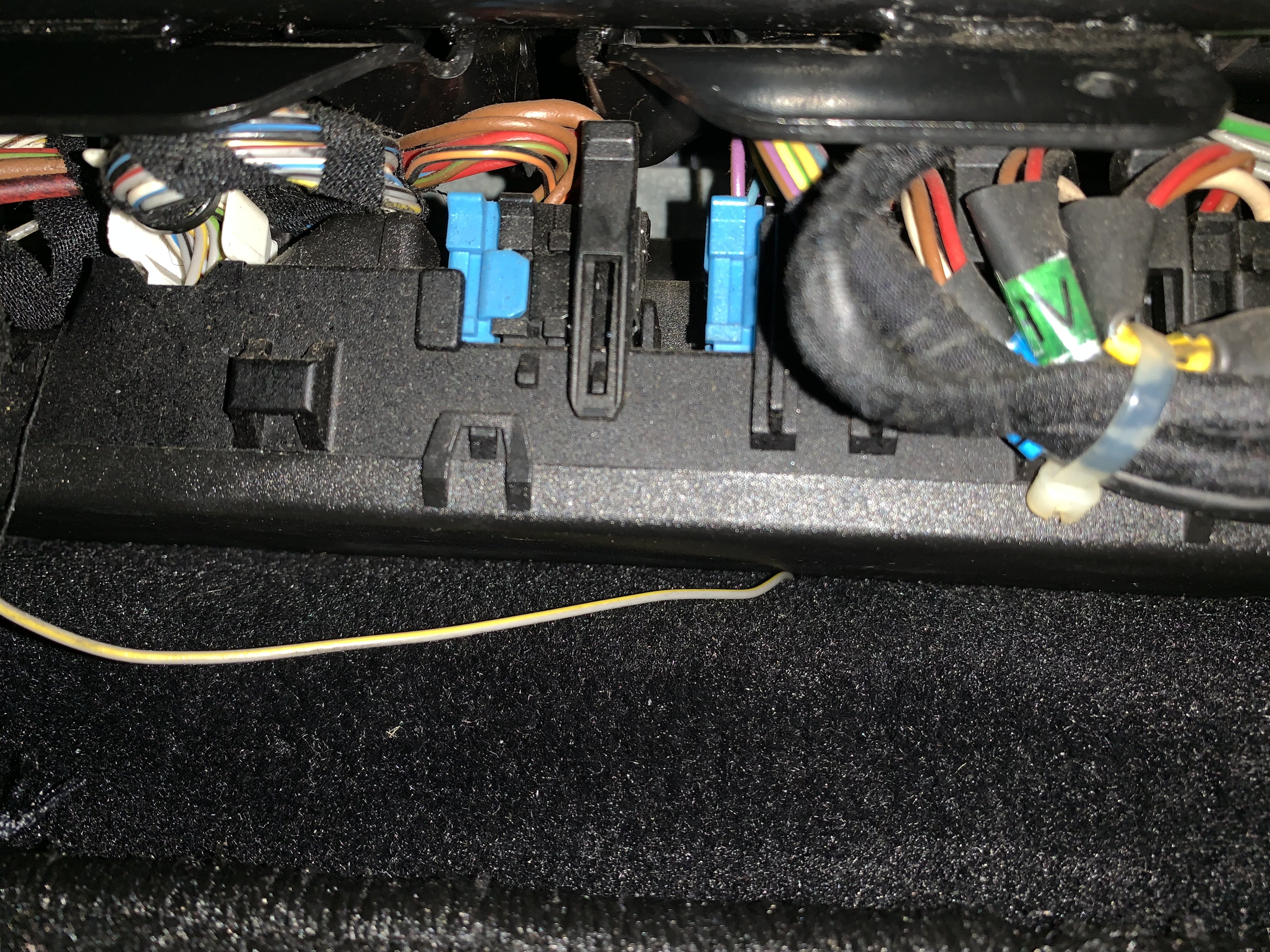

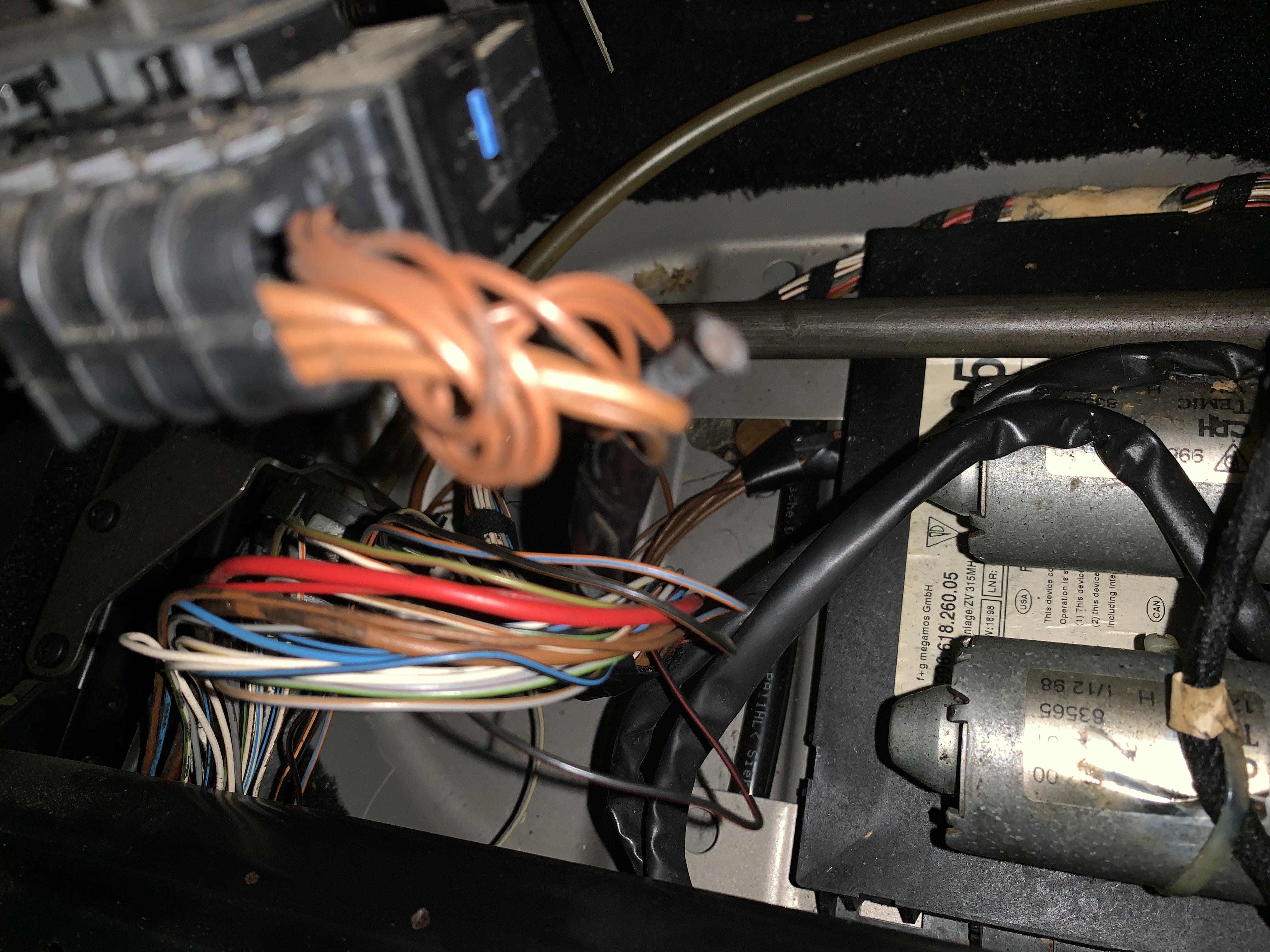

By the way, there is no way to manually adjust the seat.  My drivers seat refuses to move.  The fuse is good and I have checked every wire under the seat, both power and ground.  My Durametric software can communicate with the seat memory module and no faults are found.  I have spent hours under the seat to try and figure it out, but I have not found the problem.  Fortunately the seat position is exactly where I want it.  I suspect that either the seat memory module is faulty or the memory buttons on the door sill are screwed up somehow.  This is perhaps a better picture of the white seat clamp...pull the center pin down and it releases the front of the seat bottom so you can lift it up.  And the memory module wiring.

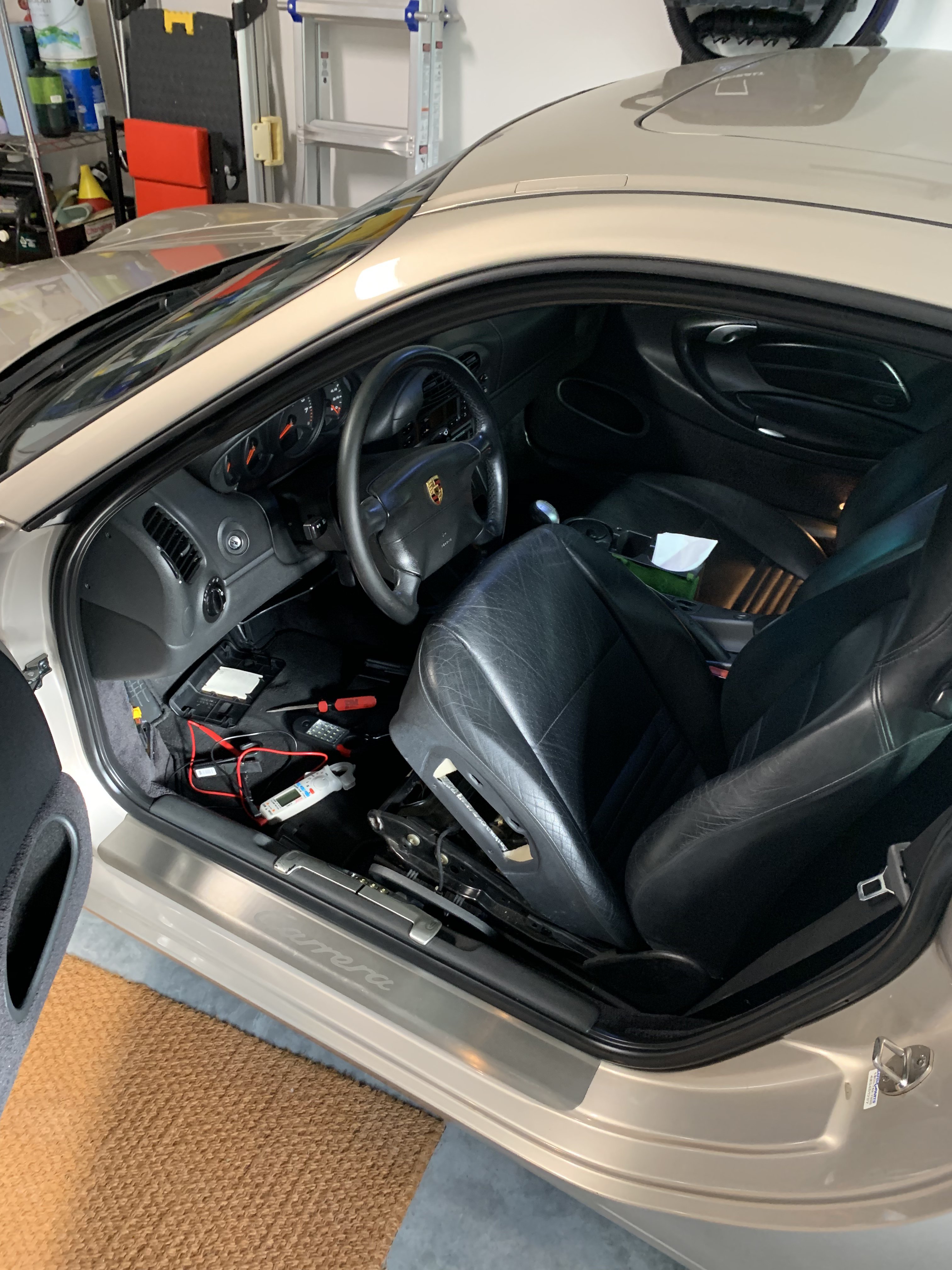

This morning I put in a new 30A fuse and without putting the key in the ignition I began to adjust the seat to my liking.
I was almost there and the fuse blew. I was adjusting the seat forward when it happened. I put another fuse in and moved the seat up another inch or so and now I'm happy with the driving position. This leads me to believe that something is shorting out under the seat(as DBJoe mentioned) and not the ignition switch. So begins the exploration.
I had a good look at all wires and connections and didn't see anything abraded. The only issue I did see is the plastic bracket that runs along the seat bottom was broken. It holds 3 connectors, 2 small, one big. The big one was not connected to it. I repaired the bracket but could not get the connector back into the bracket. Not enough room to drop the seat down far enough to meet the connector and get my hand in there and at that point I was flying blind. I'm hoping at this point, I've moved enough wires that I inadvertently fixed the problem.
At least the seat is in a good position for me.
