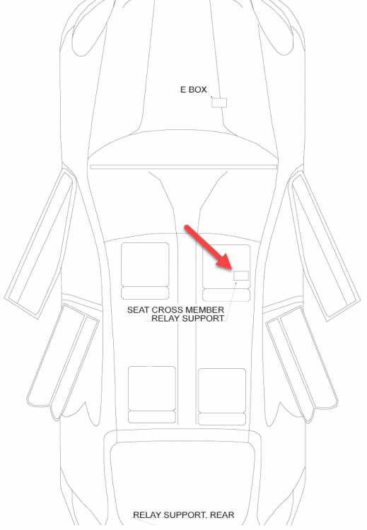

Not sure what you mean by seat cross-member?  is it possible the relay is bad with one horn still working?

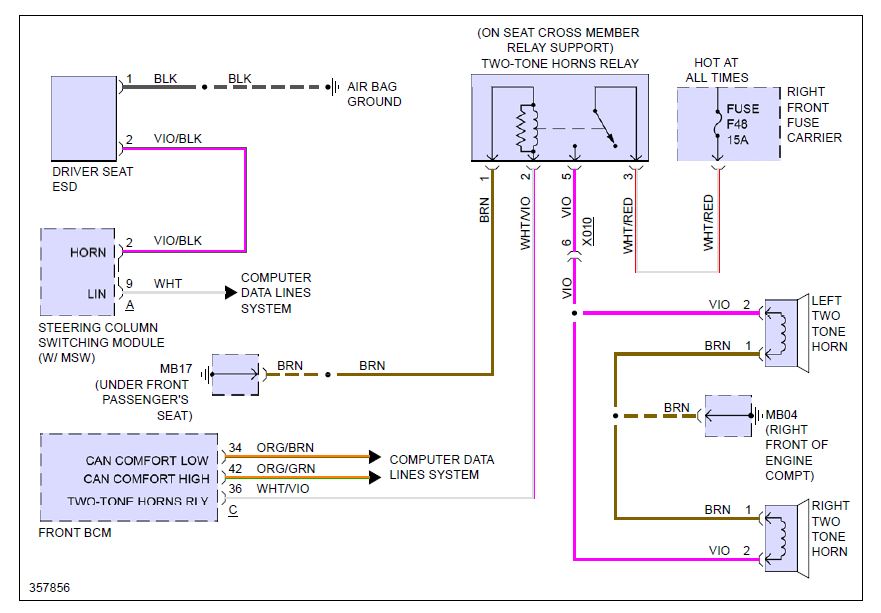

Did you test both horns when you did the replacement? The should always work when you apply 12 VDC to them.

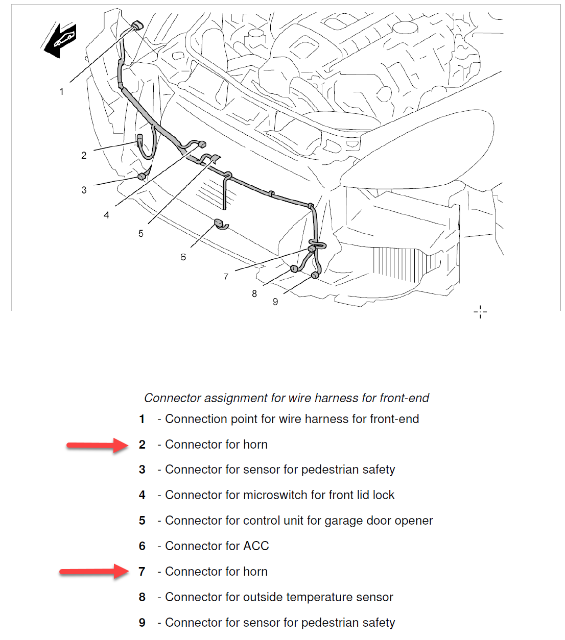

Did you check the wiring to the horns?

The alarm/locking horn is a different horn.
The front horns are cheap horns (on all Porsches)  - which is why I suggest testing them off the car with 12 VDC.

Can’t seem to find much documentation on this issue - nothing on the horn relay, or the correct part or location - despite checking those located under the hood and battery locations; nothing under my passenger seat. all the fuses are good.
