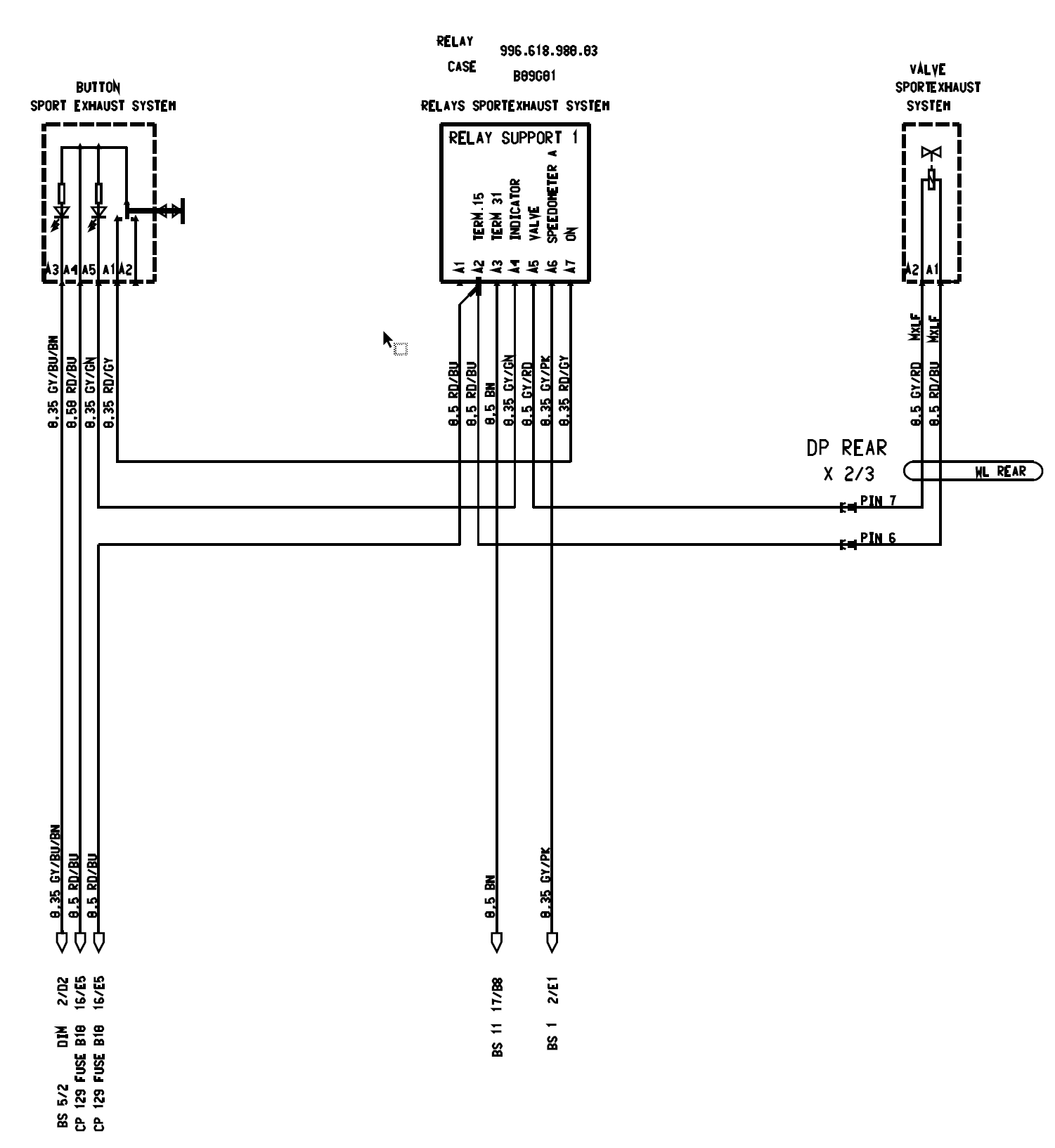

Hi Loren, sorry if I disturb you but I'm in trouble with the switch connection.
Enclosed you will find the actual connection in my Porsche Boxster 986 S (Impianto attuale.pdf).
I'm not able to follow the previous diagram because of different wire colours and I don't wont to make a mistake.
Can you help me in found the right way to connect the switch? (step by step connection/disconnection)
Thank you in advance
Best regards
Gabriele
