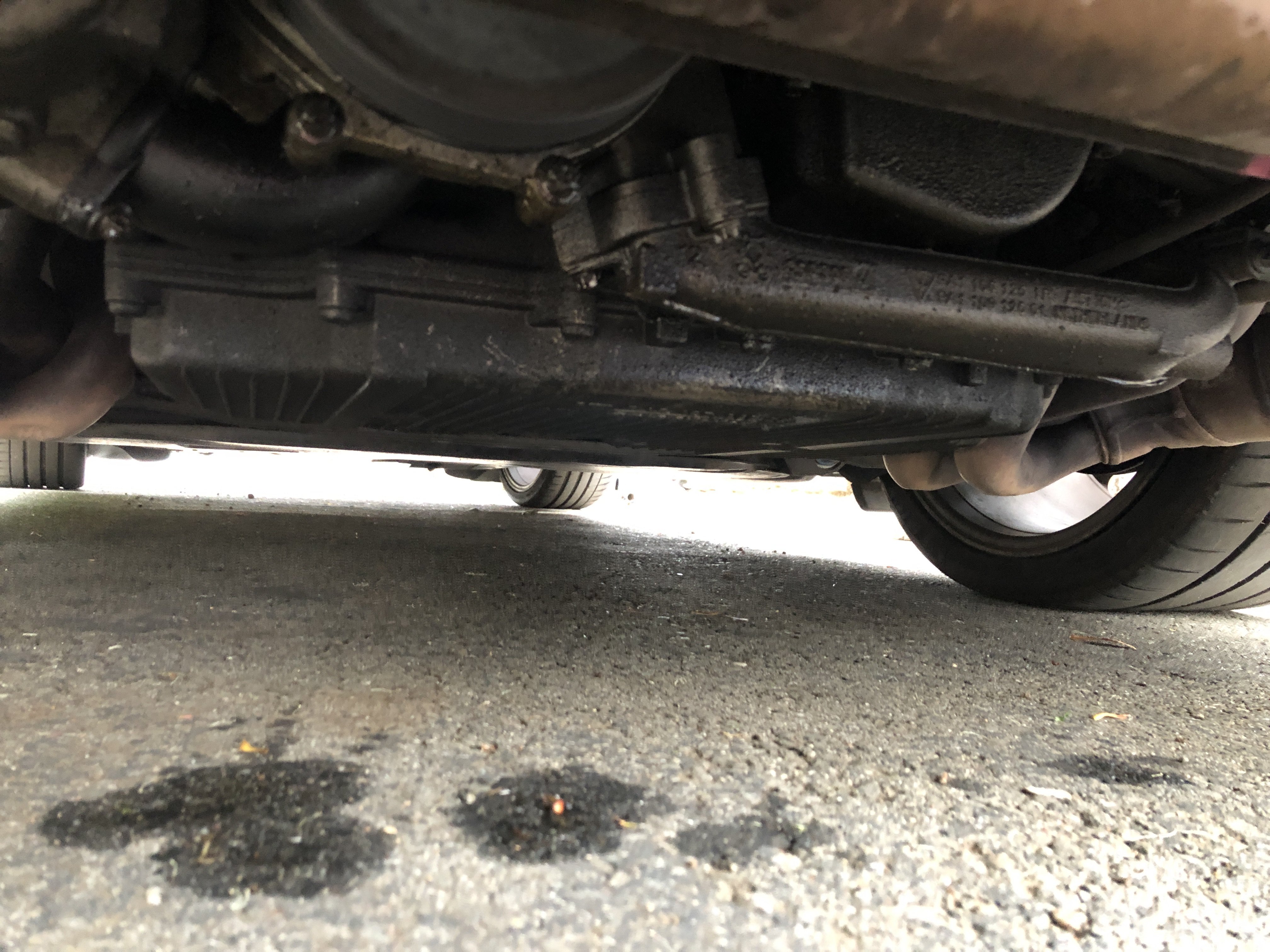

I noticed the last three days that my 997.2 C4S drips a good amount of oil on the drive overnight. I had a look at it today (and parked it in a different spot to gauge the amount of oil). I thought it might be a slightly loose drain plug or something, but appears to be coming from the rear of the engine somewhere. ?Does anyone have any ideas? I can't see where it's coming from. the major drips seem to come from the bolt at the center of the picture.

Without a good look, it is almost impossible to say where it is coming from.  A good start would be to clean off the engine and then monitor it for leaks...…..
Like JFP said throughly clean engine, including the topside, I say that because liquid flows downhill and could be coming from filter cap or filler cap
Once you get the engine spotless and dry, spray some ARRID XXX DRY deodorant on suspect areas (sounds crazy but we use it on radial aircraft Engines to trace leaks, it works) then run the engine till it’s warm, hopefully it’s nothing more than a loose cap/fitting

Long before I would be spraying deodorant all over an engine, I would add Uview UV oil dye to the oil and trace it with a black light; works like a charm but does not smell as nice.....

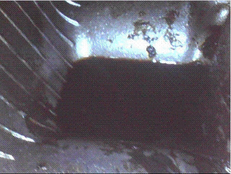

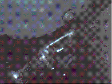

Okay.. Have some of the UV stuff coming today, but using my old endoscope to have a look around. Oil seems to be pooling to the rear and left (drivers side) of a grey circular thing behind the oil filler pipe in the center of the engine. See top left of the first picture. The second picture is a view below and to the left (drivers) of that grey thing. Other areas look clean dry but can't get to see behind the grey circular thing.
 frontaos.GIF.9e56f01ff2b0021bf153daff18c1e522.GIF1458164075_oilpool.GIF.26289c4dbe097d7553daf67f565b4f7b.GIF
I assume this is the AOS based on looking over parts diagrams. The oil filler pipe looks dry and clean where it connects so assume is fine until I get the UV stuff in.

Quick follow up in case others need this. It was the AOS. All fixed and back on the road.
