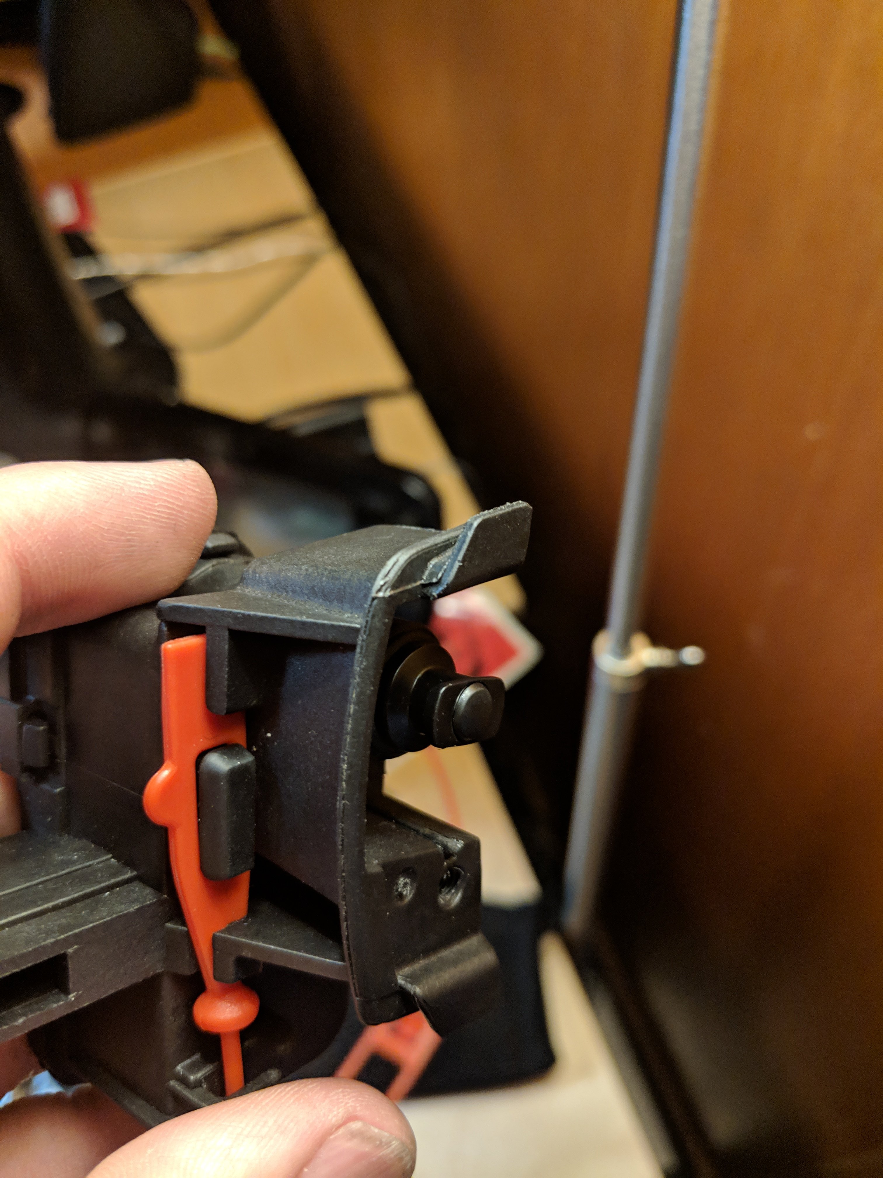

OK, so I dug in and had to unbolt a ton of modules. I could pull the old solenoid out but not without breaking the tabs on top and bottom. Now I can't figure out how to fit the new solenoid in without loosening the trim around the fuel fuller.
The tabs on top and bottom go between the plastic trim around the filler neck and the sheet metal of the quarter panel. Anyone know how to loosen the trim around the fuel filler? Otherwise I'm just going to cut the tabs off and rely on the screw to hold it in.
