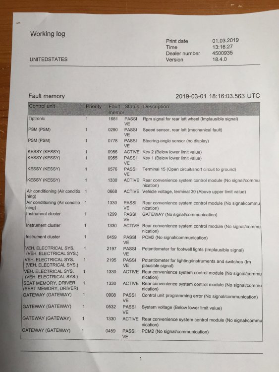

Car at dealer one hour they cant find problem yet..Attached is the printout so far..any help reading this to narrow down problem?before they rack up the hours is greatly appreciated! PCM not working or Ac/heat nor keys either..They say nothing is getting a signal..what could that be?car just sitting a couple years..Has new battery..

I would start looking at the wiring harness for rodent damage or just age cracking of the insulation on the wires.

thanks.. any particular area to check first?
Mice and rats can get just about anywhere in the harness, you simply have to get a good light and start tracing wires.  I'd start with the engine bay and any wires under the vehicle first as they are the most accessible to the rodents.

Does the car have a new (main) battery?
Yes new main..no rear battery
