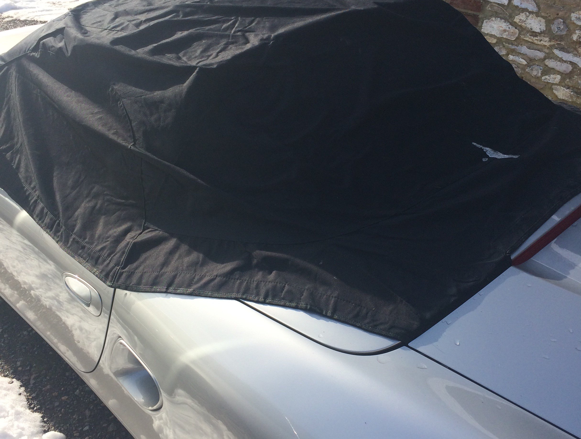

Update for ideas please.
Even with a half roof cover the water is still getting in from somewhere.
