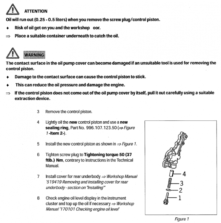

I would do two things:
  1. Change the oil and filter, switching the car to Joe Gibbs DT40, which is a 5W-40 full synthetic with high levels of ZDDP.
  2. Porsche released an oil pressure "upgrade kit" which consists of a new pressure relief plunger, a longer spring, and an end plug seal.  The entire kit sells for around $20 and can be installed at any time (you will only lose about 1 cup of oil out of the pump), but this was designed to raise the low RPM pressure a bit.
Parts:
  • Piston 997.107.125.01
  • Spring 996.107.127.53
  • Gasket 996.107.123.50

When you do the pressure kit upgrade, just be sure the original piston comes out (they sometimes stick). If it doesn't drop out, slide a small diameter magnetic pick up tool into the shaft and pull it out (it is steel and will stick to the magnet).
