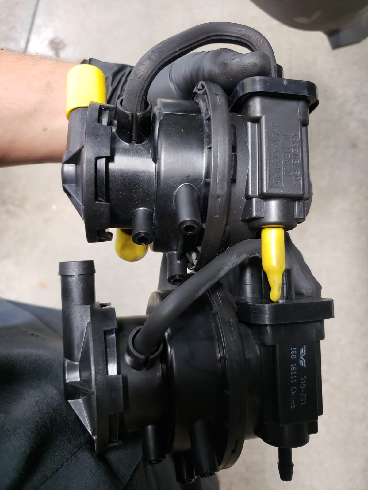

i took it to a shop to do a smoke test, they found no external leaks. They tested the tank vent valve and leak detection pump and it failed twice. (Pic attached)
so i changed the leak detection pump (95560510702), found that the one installed was a chinese brand not oem, drove the car for two days then the light came back again! Same error code.

smoke test showed no leaks, so far i have changed the gas cap, leak detection pump, purge valve and CEL still came back on...
