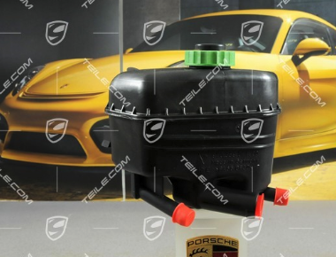

Have seen folks say its a real PITA to do. Started looking closer and found this photo of the tank itself. Somehow it does not appear to be difficult. There are 3 lines going to the tank.
Just guessing, if I was to remove driver front wheel and lining, I can get to that side. Then I could siphon out the fluid, protect the area with rags, etc, disconnect the 3 lines, and change the tank with a new one.
Anyone comment on the above, whether I am missing something?
Other folks were saying you have to remove the (serpentine?) belt, to get the tank out. I somehow do not see the need unless you are changing the lines too (unnecessary IMO, as I think they are metal).
Thanks for input. Below is pic of a new tank, showing where the 3 lines connect to it.

Why is it needed to use newest?  Is it just the age, or some technical differences?  Thank you again.
The olde part number says to use the new part number in the Porsche system. That usually means there is a design change that makes the part better or in some cases a manufacturer change.
Great.  Thanks.  The part is one you provided so much obliged for the check.
