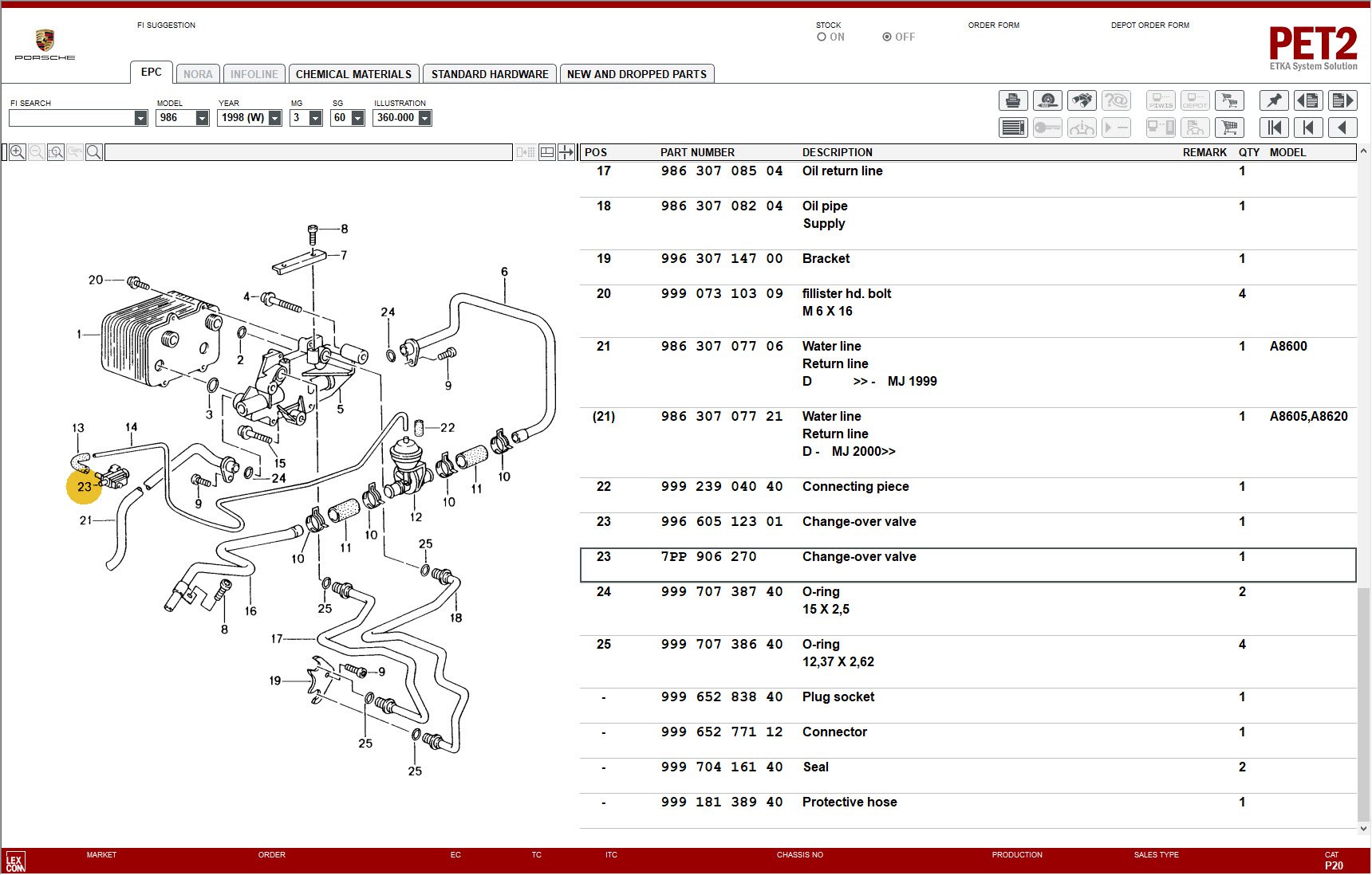

Okay!
Which is the parte Number?
do you have a diagram?only to understand the location of this valve..
Thank you:-)
PS is It possibile the valves are two?

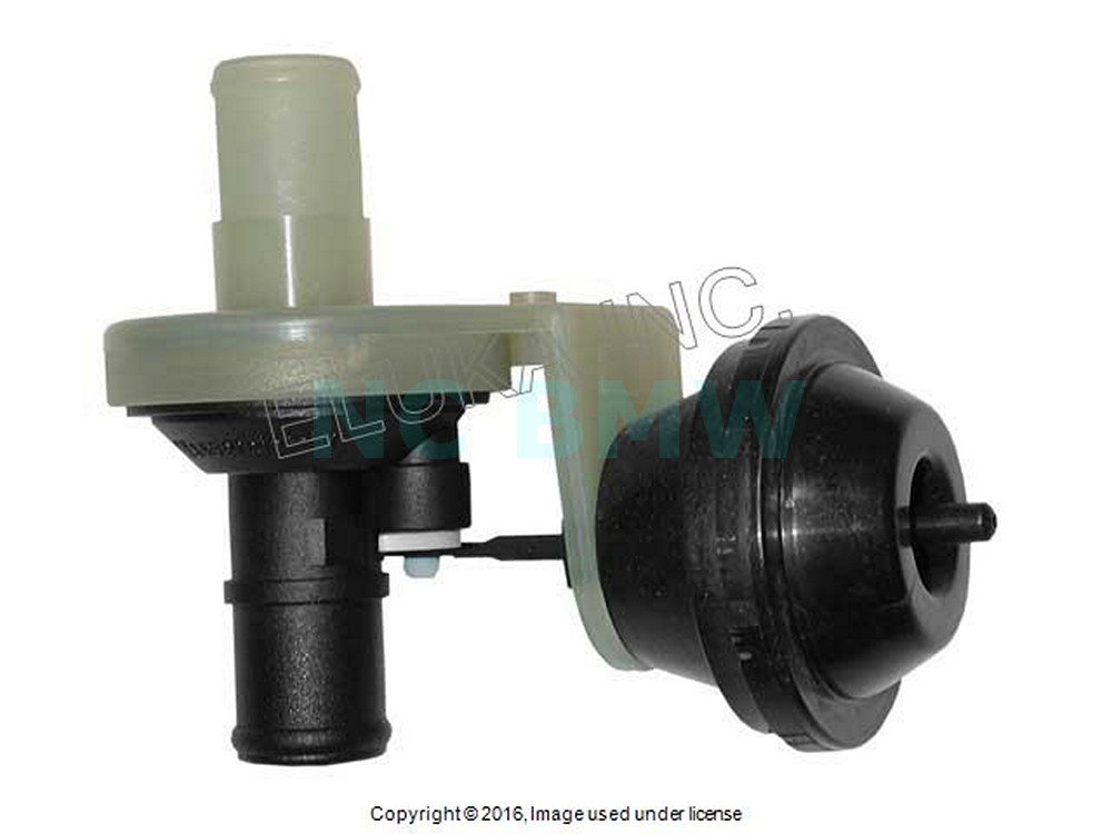

9 hours ago, Fulvio Marco said:
One more question.. valve n. 23.. is It accessibile from the engine?
Only if you have really small hands and long arms; this is why the transmission needs to be lowered slightly...…………..

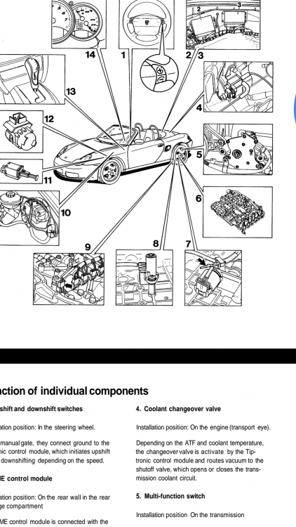

18 minutes ago, Fulvio Marco said:
Is this the location of One of the 2 valves?picture n. 4
7pp906270 .. engine compartement?
No, that is the electronic change over valve for the SAI system, not the Tiptronic trans.
