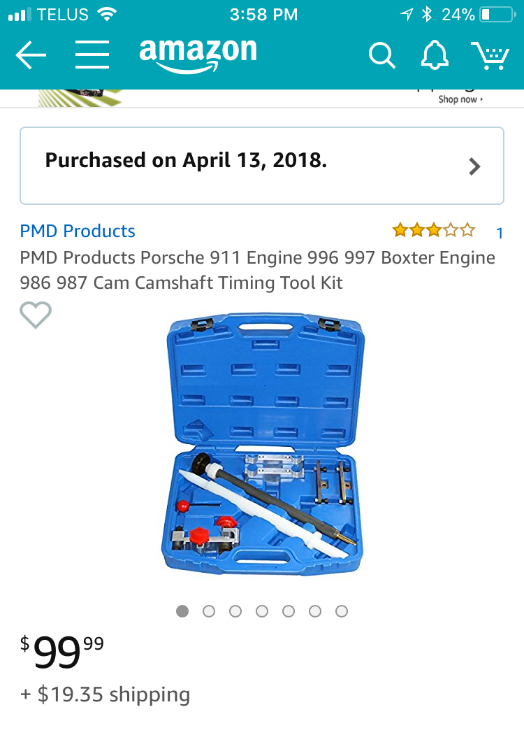

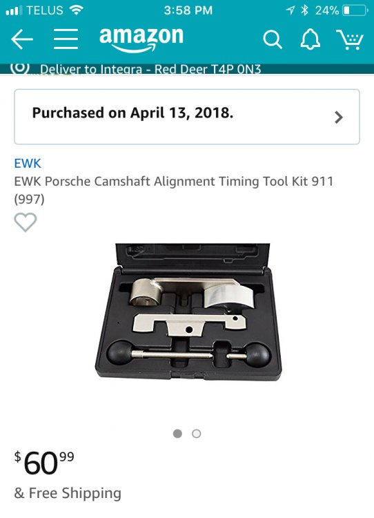

Thank you all for your help, what is different about my M96.03? Vertex shows one tool for my year and another site says will not work on M96.03 I believe it’s not the 997 tool. Can I buy the cam lock/holder by itself?
I don't think so. Basically you need to buy both kits to get what you need for cam timing. The extra tools that you don't need are for 3.4/3.6 engine assembly and 3.4 engine cam timing.

Trevar, I see that it has been about 4 years since you purchased the EWK timing tool for your 911. I just had one of those cheap aluminum tools fail on me causing my timing to shift while torquing down the big camshaft nut. I may have bent a valve in the process! EWK is not making that set in 2022. So, if it is tucked away in your garage would you be interested in selling it? I can pay via Venmo right away. Thanks for your help.
