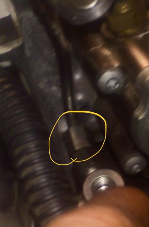

Sorry I am a novice but your guide has led me every step of the way. I have uploaded I picture of the rail the i unscrewed. The nut I unscrewed from the top is circled at the bottom. When I pivot the manifold from the passanger side, the rail doesn’t move much. Why isn’t it wiggling loose? Am I wiggling the right thing?

You can kind of tilt the intake manifold towards the back firewall and free the fuel line after you’ve pivoted it up. It does take a little bit of wiggling/working it. It’s a flare fitting which looks like a cone that fits inside another cone. The fuel line flexes around a little which provides the resilience you need to pop it out.
You can pull the line down a little with your hand to free the cone from the upper fitting.
