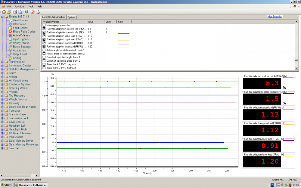

I think that i should reboot "handover" DME but in Durametric i can't find "basic settings" for RKAT, FRAO, FRAU (long&short time fuel trim) etc ...
Is possible to do it using this tool or just disconnect battery for night like in 986 & 996 ???
I put screen from durametric from today morning. FRAOb1,b2, FRAUb1,b2 and RKATb2 are pretty ok, but i am not sure what with RKATb1 on passenger side ?? 5,3% ??
Regards
Peter
Edited by Peter_Ch
"Handover" is not possible with the Durametric system, but disconnecting the battery should force the DME into a "relearn" cycle.
Thanks for reply, do you think i have to connect two wires "+" & "-" together or just disconnect one of them ? As you know in Cayenne battery is under driver seat so i would have take off this seat, but i have idea to disconnect "+" of battery in small hole near gass pedal ?
You should only need to disconnect one battery cable, which ever is easiest to get at, it is not necessary to touch the cables together.  Just be careful working with the positive cable away from the battery as it is hot and can arc easily.  Normally, we suggest disconnecting the main ground as that will have the same effect, but eliminates any chance of an arc.
