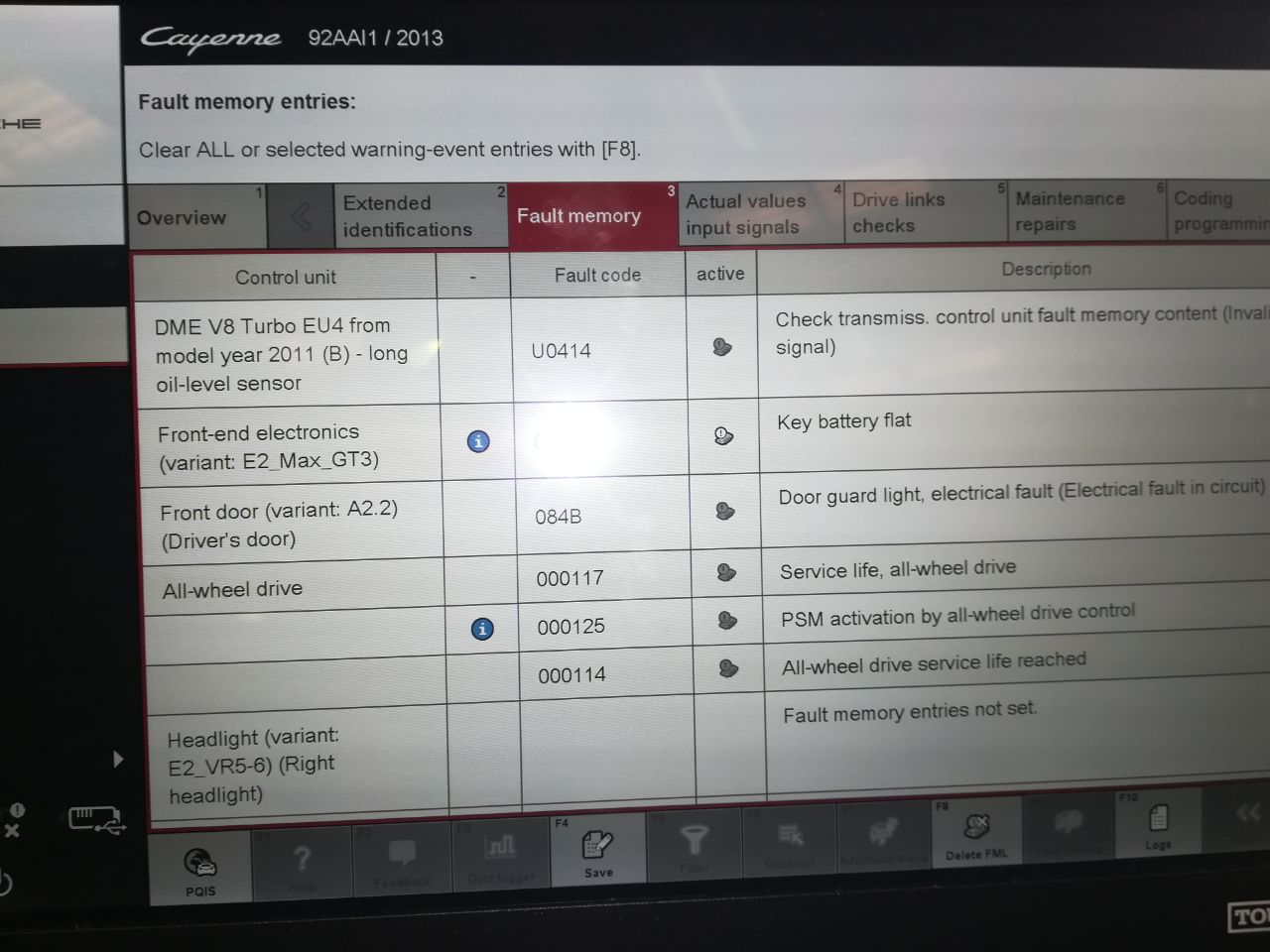

So I had the car diagnosed using Porsche software form the dealer and got the following screenshot....
Can anyone confirm what the culprit is?
