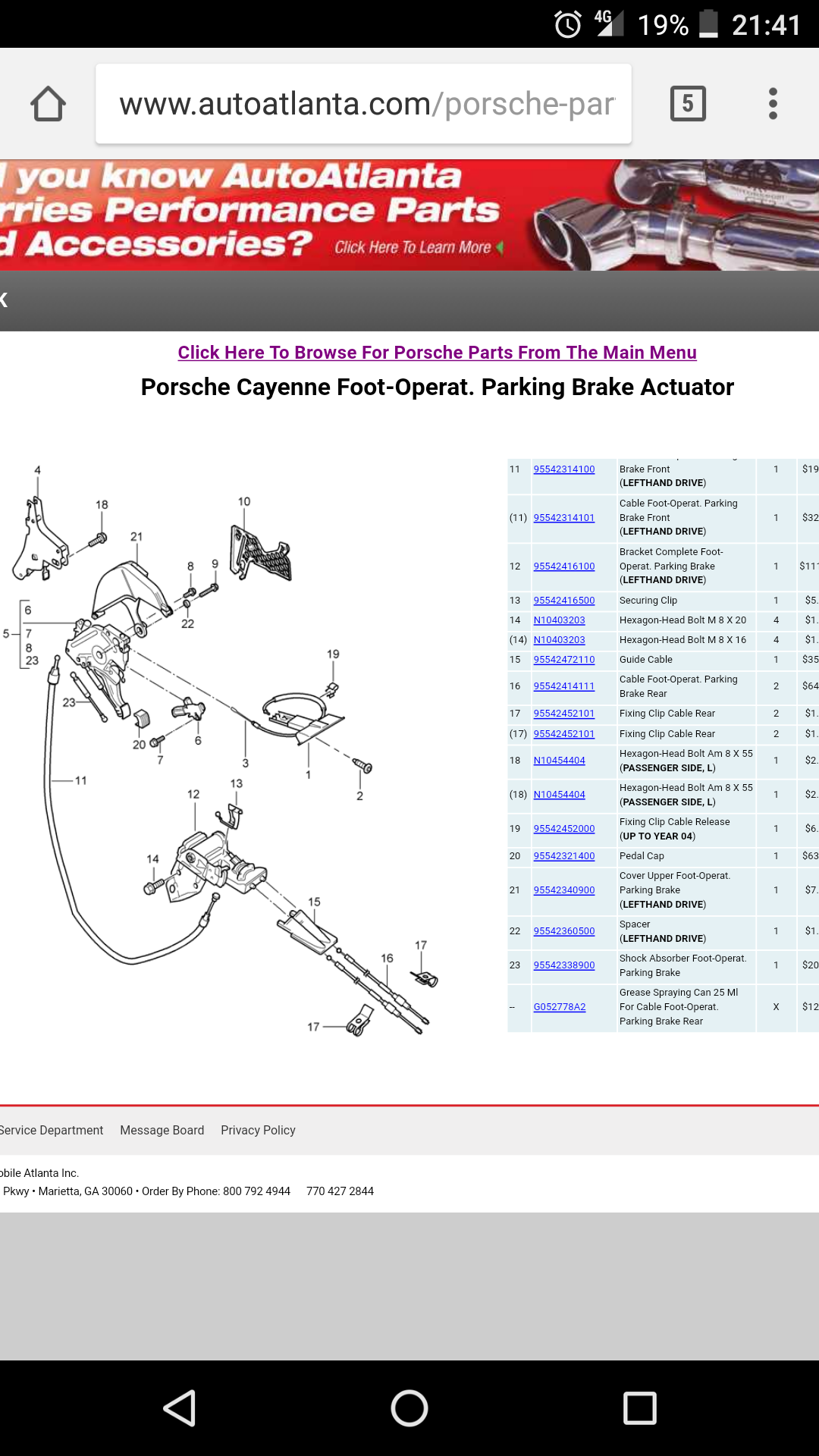

Yes, I’m sorry the parking break light stays on. How do I replace the strut sir Lewis? Do I just remove the trimming and it will be right there? Do you have a part number I can reference? Thank you very much,
David,
David,
https://www.pelicanparts.com/techarticles/Porsche-Cayenne/17-BRAKES-Parking_Brake_Strut_Replacement/17-BRAKES-Parking_Brake_Strut_Replacement.htm
Item 23 mate
