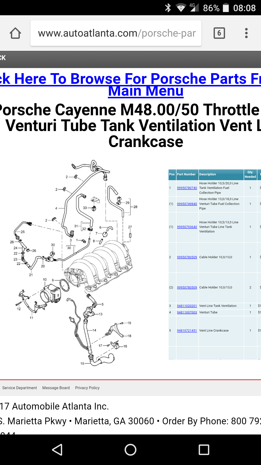

Intake air leak for sure.
Check the Y pipe and it's fitting underneath pipe 4, check the connecting pipes jubilee clamps are tight, check the smaller pipes connected to the throttle assembly are all connect properly.  The pipes are prone to splitting also.
Check 25, 14, 13, 5, 4 oring 9 can leak but don't make sense that it would assuming they didn't remove it, check 24 directly under the throttle assembly is not rubbing against your water pump pulley.
If your still stuck smoke test your intake. Search my posts about that. Simple home made smoker.
