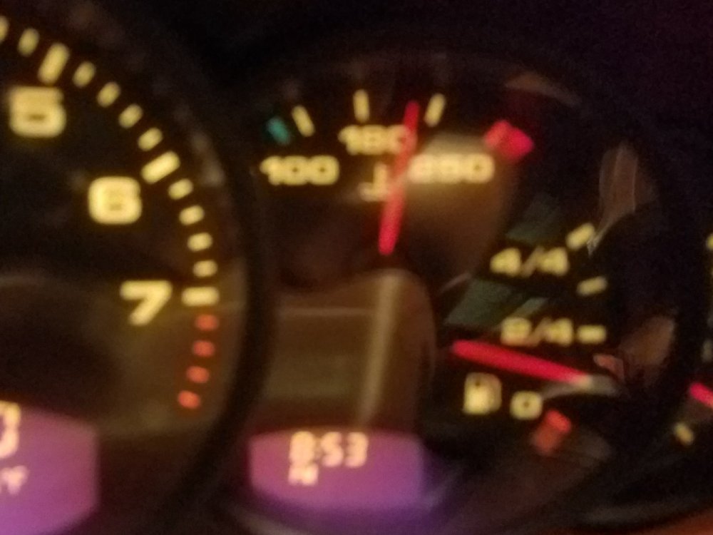

I have a 2001 996 Carrera Cabriolet with 133,470 miles and a coolant temperature issue (see photo of gauge at 75F ambient temperature after sitting idle for a few minutes)

Have you tried using an OBDII reader to read the engine temp? Also I think you can read the engine temp on the climate control.
Did the fans come on when you took the photo?
Has this arisen suddenly or has it been an issue over a period of time? If the latter, had you just replaced something when the overheating started to become an issue?
Is the waterpump a Porsche one?
Thanks for your help - I think I got to the bottom of it... I needed to properly burp the cooling system, which I have now done and I'm pleased with the results.  I appreciate everyone's help!
great.  good find.  your area does get a little bit warm.  Consider adding Water Wetter to coolant if any topping up is needed.
