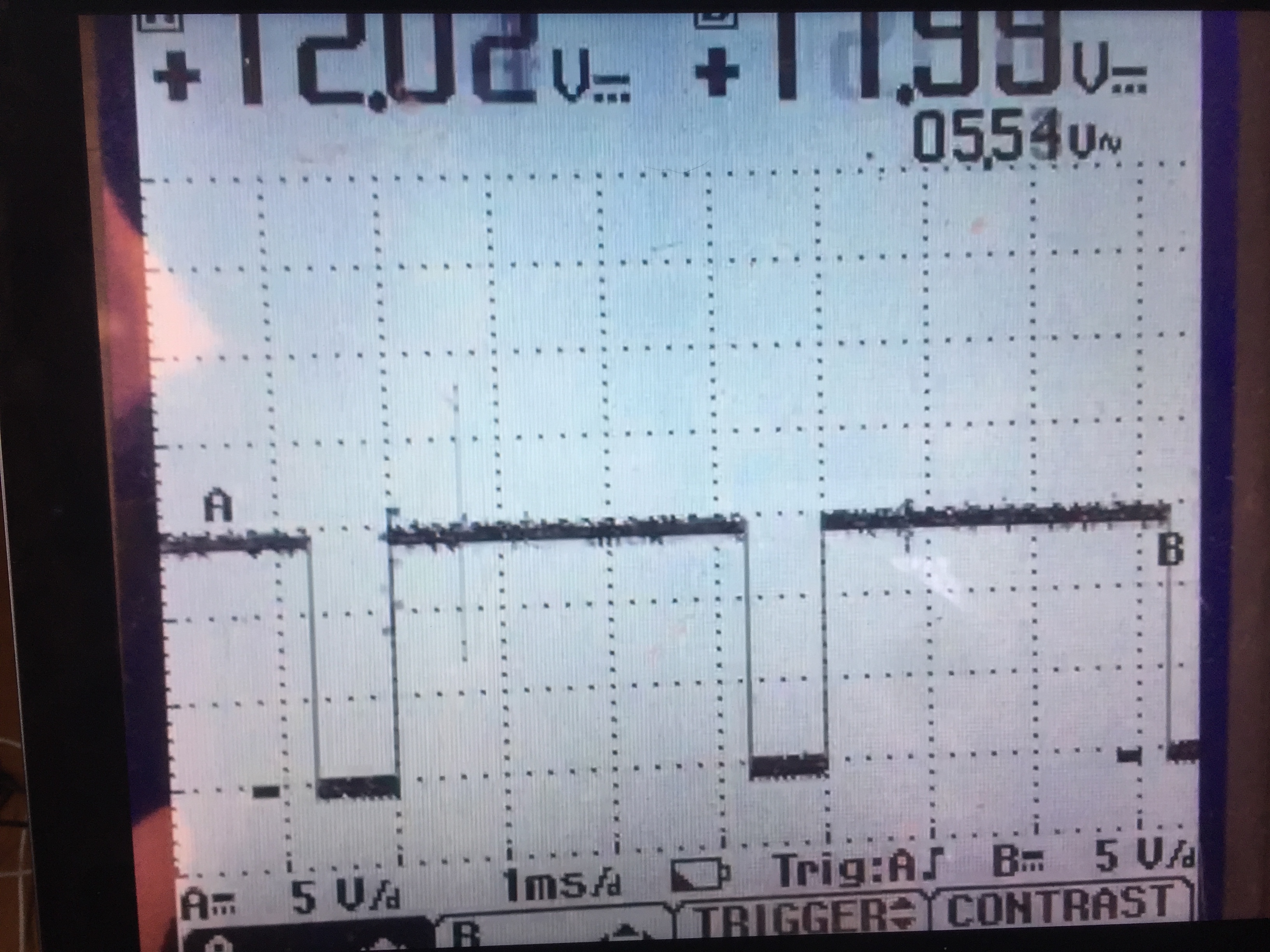

just bougt a cayenne turbo 4.5 2004 with engine problems.
It runs smoot but has very low power and i read code p0344.
i have no history so i have to start somewhere.
i replaced both sensors and readout them with a 2 channel scope (see below)
both signals are in line but....i miss the small pins from the wheel.
anyone ever seen this?

Thanks.....turns out that someone puts in the wrong cams with bother wheels on it. Problem solved
