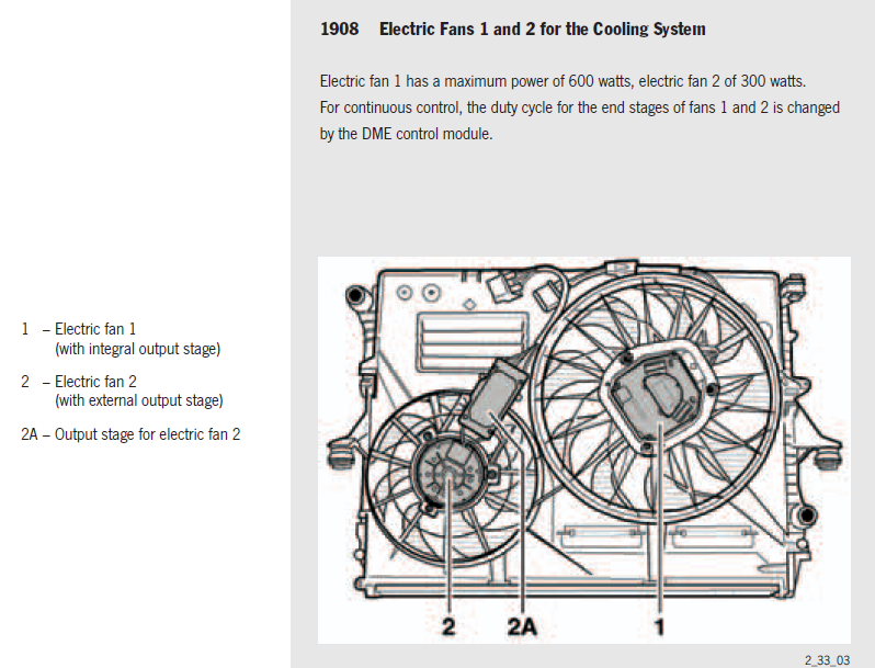

I think you may find that the main cooling fan speed is pulse width modulated, meaning the fan motor speed is infinitely variable by PWM electronic control; so there is no low and high speed.
the cooling fan spins all time with the same speed. my problem is that the temperature goes a little about 180 and the water comes out by the reservior then the fan kicks in and everything is ok. thermostate waterpump headgaket is all new.
The speed is controlled by the DME - which means the DME runs it as fast as needed to properly control the cooling.
In the older cars, you only had high speed or low speed -- so now you have variable speed control. The variable speed will minimize temperature spiking between settings.

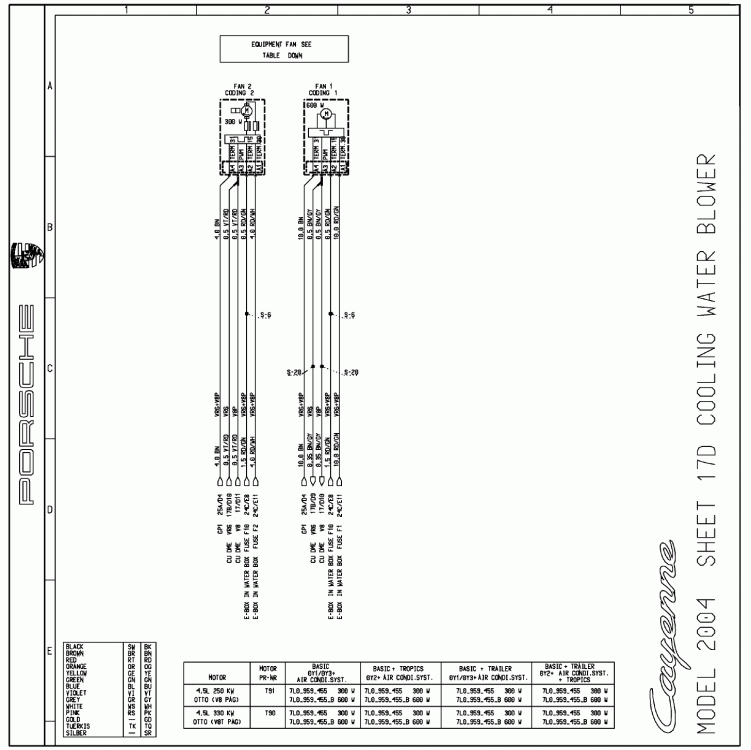

how i can check the speed control?
The speed control is solid state and built into the fan motor itself.  I believe that a PIWIS unit is capable  of testing the system.

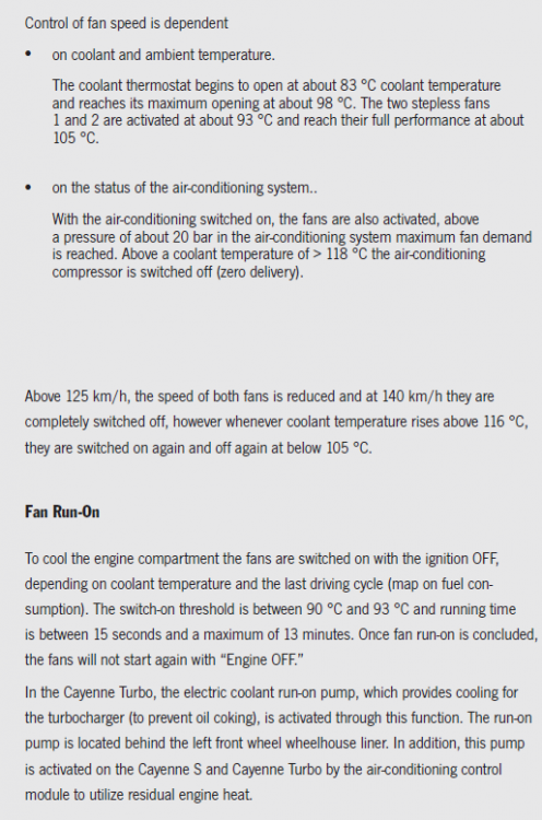

For your info and as Loren posted, the fan will not kick in unless the coolant temp is higher than 93oC, but if the AC is on fans are running anyway. To ensure your thermostat water pump and fans are working correctly (assuming all air is bled from system already) you sit at idle with the AC off. The temp gauge should rise to the mark between half and 3/4 then the fan should kick in and the temp will drop to half way on th gauge, this sequence should repeat itself.
If you live in a hot climate the gauge can also do this at highway speed also depending on engine load but must never go to 3/4 or above as this is overheating for sure.
