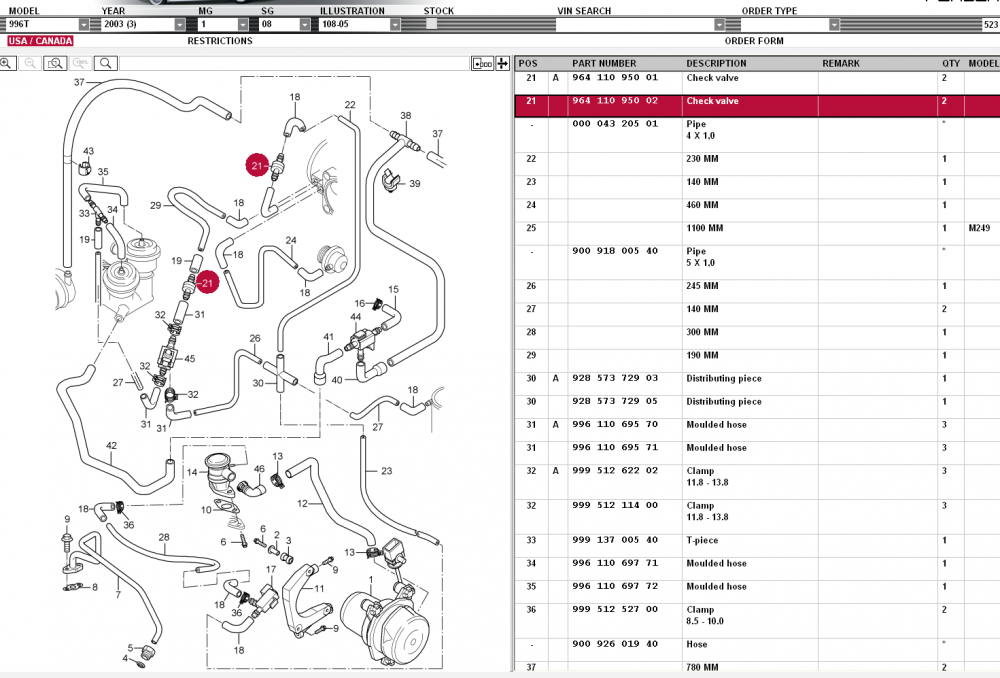

PET only shows the Socket Fitting throttle hose P/N 99611065770, but doesn't show the fitting/line where it connects.

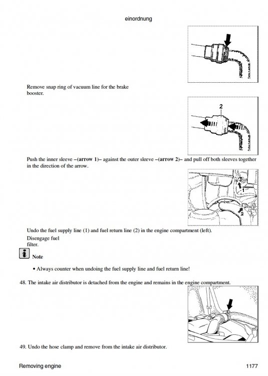

Loren,
I believe it is the black plastic brake booster vacuum line. The white piece in the picture is a coupler that fastens the hose nipple to it. I am trying find the PN for the line.
