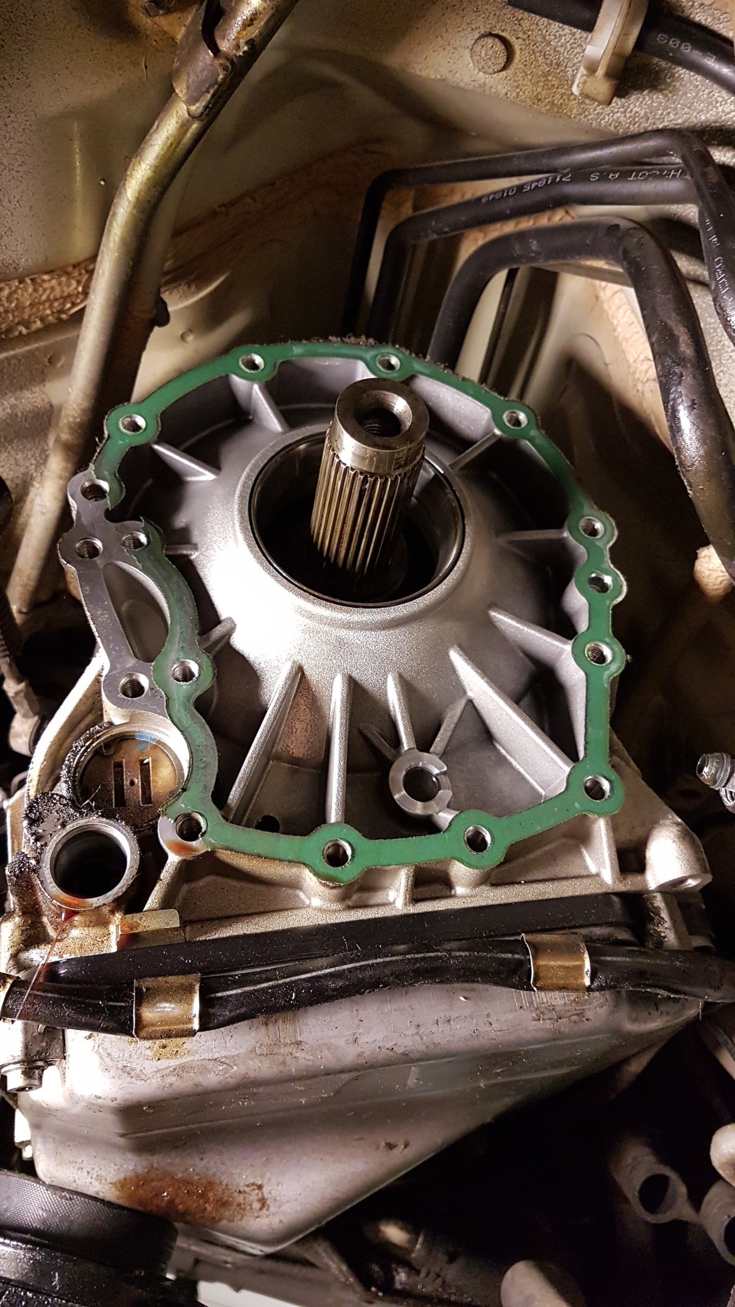

I had the common leak on the transfer case on my 996.2 tiptronic. I have stripped it all done and got the replacement gaskets and 'o' rings and now building up again.
The only thing I don't have and is not in the Porsche Workshop manual is the torque settings for all the bolts I need to put back in.
I have found on another forum that the case bolts are torqued to 19lb ft, hex bolts holding the gears in place are 38lb ft.
Can anyone confirm this before I put it all back together?
Picture shows the part of the gasket that has gone (think this is usual).
Thanks Loren

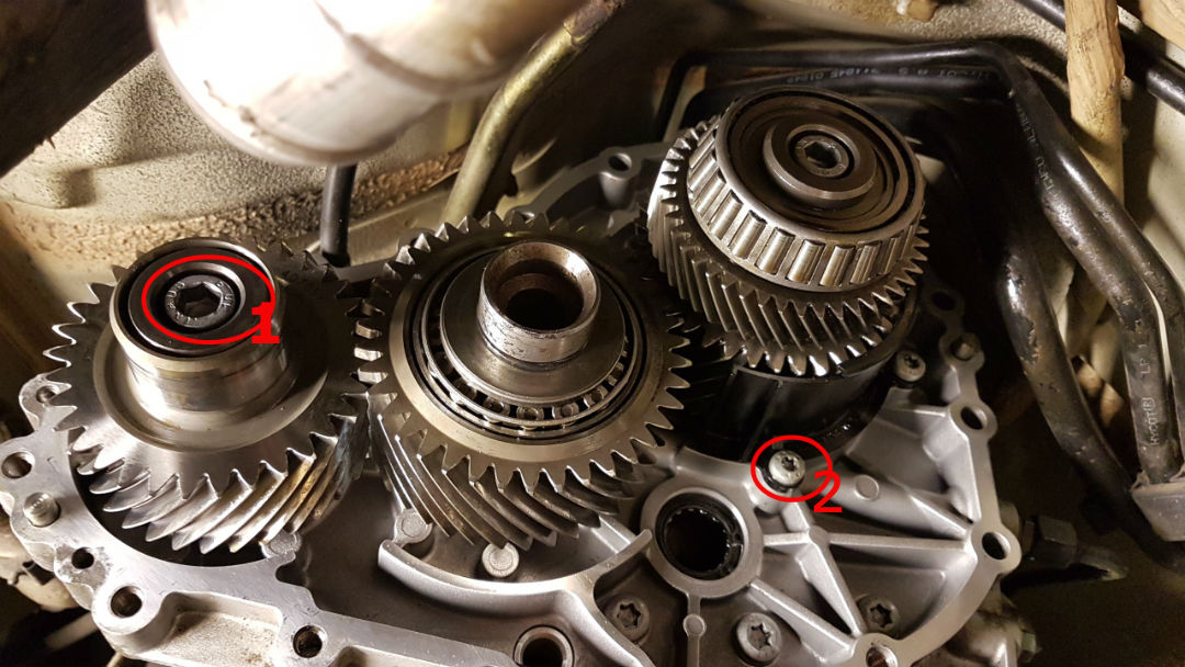

That was a great help, I'm now at the stage shown in the picture
Do you have the torque for
1. Holds the left and right gear...currently @ 39lb ft
2. Holds the plastic oil tray underneath the gear...currently 10lb ft
