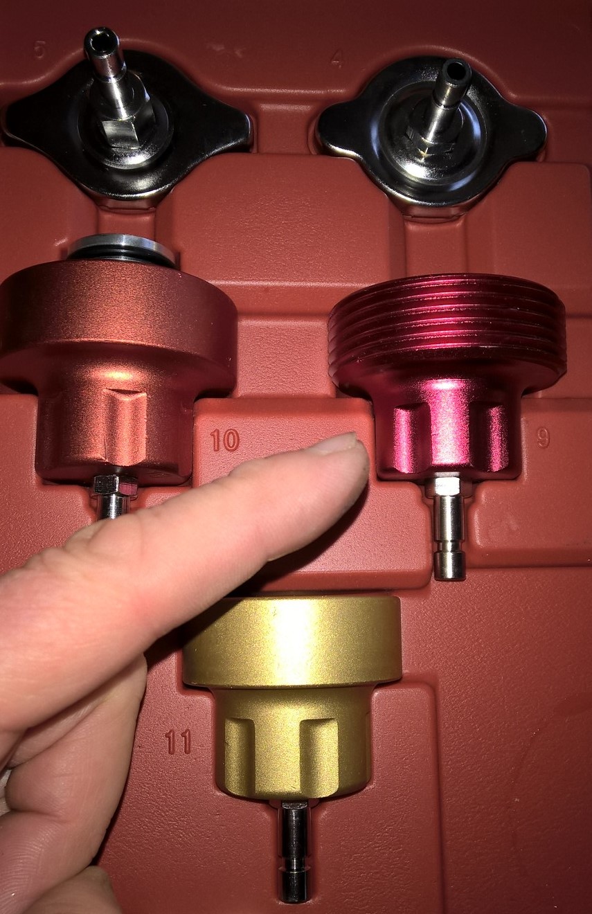

I needed to pressure test my coolant system to identify a leak that, when hot, could be smelt but not seen & when cold didn't leak!
I wanted to buy a Coolant Pressure Test Kit but was not sure which one to buy. During my research, I noticed there was one type of generic non-branded 'universal' kit that appeared multiple times on the general market (eBay & Amazon for instance).. Most listing for this generic kit listed all the car types it would fit but of course, Porsche was not listed - however, a few VAG applications were listed so I took a punt & ordered one of these kits for UK £45.00.
The good news is that one of the VAG adapters supplied (#9) fits the Cayenne the header tank & I was able to perform the test on my cold engine & immediately, the leak was apparent.
The purpose of my ramblings here is to share with you the kit I bought & the adapter used so you don't have to guess & take a chance as I did.
I hope this helps someone.
BTW, finally my luck ran out - it was my original plastic coolant pipes that gave up the ghost (there can't be many 2003 models out there still running their original plastic pipes)
