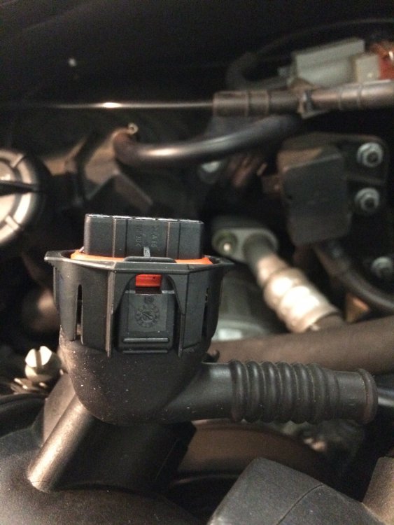

Thanks! I wasn't planning to change the plug, I just need the locking piece that comes off the connector.

JP do you know where I could ge a replacement without purchasing the wiring loom?

Most of the wiring connectors used in these cars are VW/Audi parts, and while Porsche does not sell them separately, VW and Audi do, as do aftermarket vendors as well.  You need to try to identify the connector part number and search the internet.  You can also try some wrecking yards.
JP I have been doing exactly that without any luck. The #s on the connector don't seem to mean anything, but thanks!

Have your taken the old connector into a VW or Audi dealer and asked them to try and match it?

Yes. My dealer suggested that I go to BMW

Can you please post a picture of the plug that include all the number? I might be able to come up with a source.

Thanks! I have searched high and low.
Please pull the rubber boot and look for other part numbers. You might have to remove the plug and look at the other side too. Also take a picture of the pin out of the female side.
