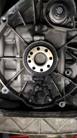

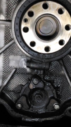

Just want to share the pictures of my 1999 C4 convertible RMS IMS.
If I am right, this seems to be a double roll bearing with minor leak from the RMS and possible some on IMS.
Browsed online for the bearing and found way more choice on improved bearing than just LN Engineering.
Anyone tried other improved version?  Roller type? Pelican part ( Cheapest)?
How bad is the leak?
